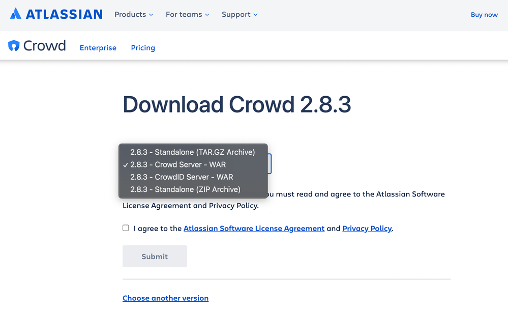

Ruslan Tkachuk
May 19, 2022
Hi @John Oliver
If look into the Crowd 4.0.5 archive you can find, that it contains a web server (apache-tomcat folder), but Crowd 2.8.3 has the option to be downloaded with a web server (2.8.3 - Standalone) and without (2.8.3 - Crowd Server) see attachment.
As you mentioned, on your Windows Server 2019 was deployed Crowd 2.8.3, so I can suppose that it was "2.8.3 - Crowd Server" and additionally installed Apache Tomcat (with the specified environment variable CATALINA_HOME). And when you run Crowd 4.0.5 through the command "start_crowd.bat" in fact you run a web server that is installed separately.
Solution: delete environment variable CATALINA_HOME and try to run Crowd 4.0.5 through the command "start_crowd.bat"
