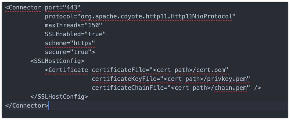

If talking about the SSL certificate, then Crowd doesn't directly integrate with it. Only Apache Tomcat holds all required configurations for support SSL.

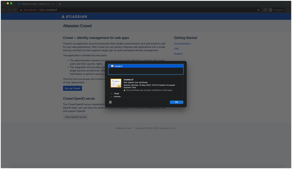

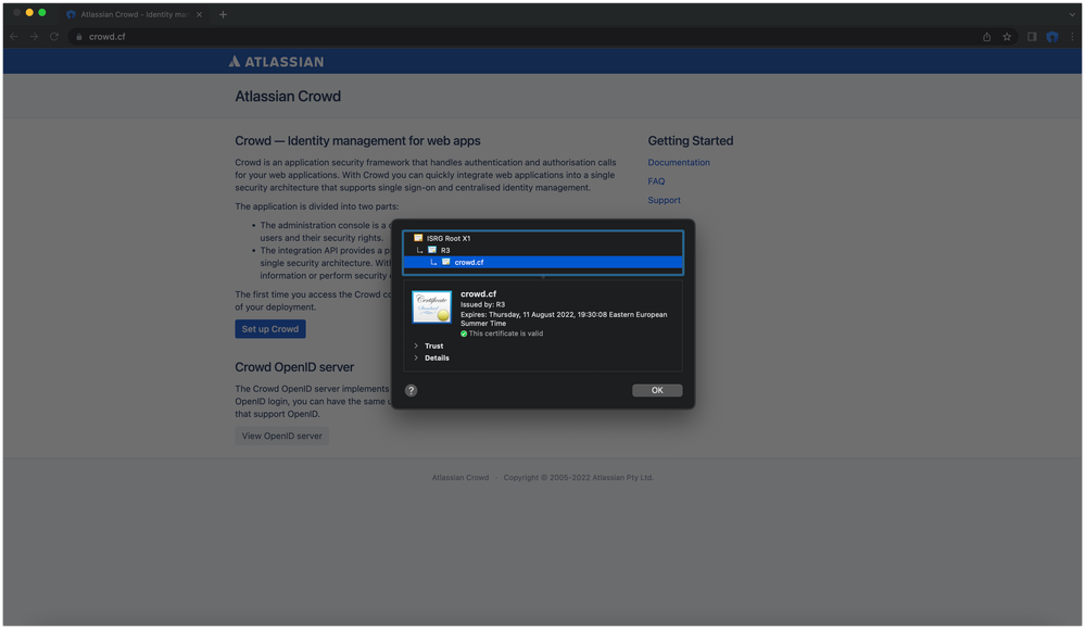

I checked the proposed configuration (official Atlassian Crowd documentation) with the Self-Signed certificate and with a certificate issued by CA (https://letsencrypt.org). In both cases, everything works as it should, but the Connector configuration for a certificate issued by Let's Encrypt is a little bit changed (see below).
So, if you are sure that it is all configured correctly, then I recommend trying to find the root cause of the problem on the client-side and maybe some recommendations provided in this article help you https://geeksadvice.com/fix-net-err-cert-date-invalid-error
