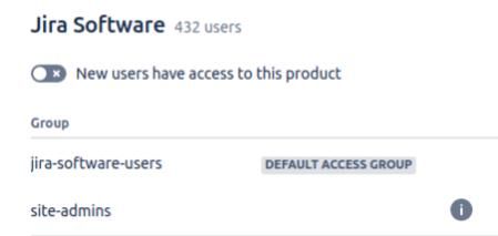

My Default Access Groups config is correct:
And when I create a new user via UI, this does not happen.

Welcome to Community! with your code, this shouldn't add the user into any group, given that you've disabled the default access group for "jira-software-users" under Product access. Do you have Atlassian access subscription on your organization? it could explain why the default group keeps getting added.
