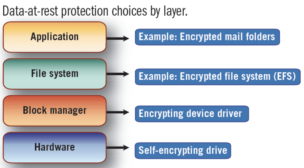

All files like attachments, and Jira database (PostgreSQL) must have an additional layer of encryption with the AES algorithm.
As a possible solution we did via LUKS, as our setup worked on an RHEL based OS.
Because it’s quite cheap solution and lower that filesystem, if your sysadmins used a different one.
The best one is hardware level (i.e. NetApp encryption , but sometimes customers want to economy the solution and meet with some IOPS bottlenecks)
