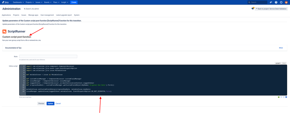

You will need to use the Custom Script Post-Function.
Below is a print screen of the Post-Screen configuration:-
