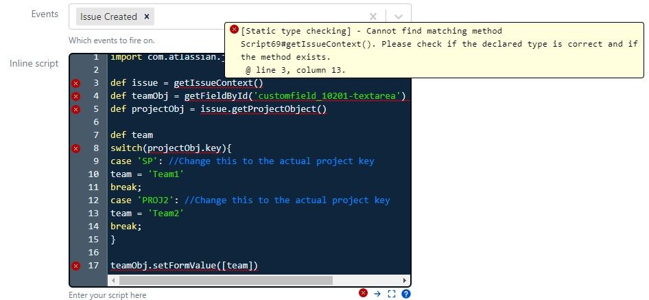

def issue = getIssueContext()
def teamObj = getFieldById('customfield_10201-textarea') //Custom Field ID
def projectObj = issue.getProjectObject()
def team
switch(projectObj.key){
case 'SP': //Change this to the actual project key
team = 'Team1'
break;
case 'PROJ2': //Change this to the actual project key
team = 'Team2'
break;
teamObj.setFormValue([team])

Hi @Ronak ,
Add this to ScriptRunner Script Listener.
The parameters under Script Listener will be.
Project(s): All Projects
Event: Issue Created
import com.atlassian.jira.event.type.EventDispatchOption
import com.atlassian.jira.issue.CustomFieldManager
import com.atlassian.jira.issue.IssueManager
import com.atlassian.jira.issue.MutableIssue
import com.atlassian.jira.issue.fields.CustomField
import com.atlassian.jira.issue.label.Label
import com.atlassian.jira.project.Project
import com.atlassian.jira.user.ApplicationUser
MutableIssue issue = event.issue
IssueManager issueManager = ComponentAccessor.getIssueManager()
CustomFieldManager customFieldManager = ComponentAccessor.getCustomFieldManager()
ApplicationUser applicationUser = ComponentAccessor.getJiraAuthenticationContext().getLoggedInUser()
CustomField teamObj = customFieldManager.getCustomFieldObject('customfield_10701') //Change this, remove the -textarea
Project projectObj = issue.getProjectObject()
String team
switch (projectObj.key){
case 'TS': //Change this to the project key you have
team = 'Team1'
break
case 'PS': //Change this to the project key you have
team = 'Team2'
break
issue.setCustomFieldValue(teamObj, [new Label(null, issue.getId(), teamObj.getIdAsLong(), team)] as Set)
issueManager.updateIssue(applicationUser, issue, EventDispatchOption.DO_NOT_DISPATCH, false)
