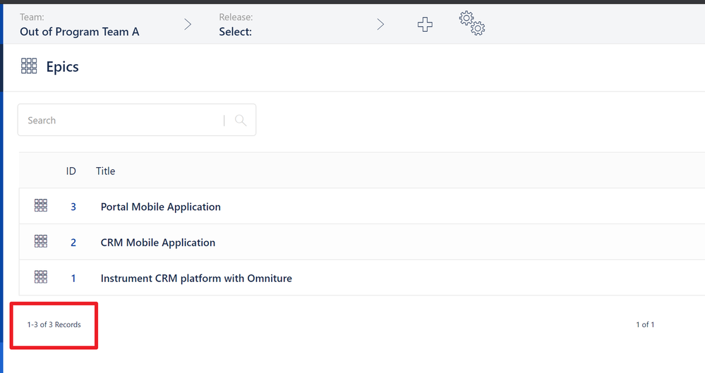

Work Item Count
When performance is impacting a certain team, much like T1 config, it can be related to the amount of data that the team needs to deal with. By work item counts, we mean navigating to the individual work item grids and getting a count of items this team is dealing with, for example on the Epic Grid (but we should get a count of every item type the team would work on):
