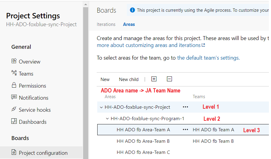

In ADO, Teams contain the people and are then mapped to ADO Areas. The ADO Area path represents the organizational structure.
For synchronising with Jira Align, the ADO Area Path is what is relevant.
ADO Area names are what sync into Jira Align team names. This can be confusing, as the assumption is that it’s the ADO Team name that would sync with the JA Team.
The ADO Team members do NOT sync into Jira Align. Whoever is assigned to an ADO work item will get synced into Jira Align.
To summarise
  1. ADO Area Name → becomes the name of the Jira Align team
  1. ADO work item assignees → Jira Align work item assignees
ADO Area names are what sync into Jira Align teams. ADO Work item assignees are what sync to Jira Align work items.
The ADO Team object is NOT used by the ADO Connector.
It’s important to take note of the hierarchy of the Areas in order to configure the ADO Connector. The levels of ADO Areas that you wish to sync over into Jira Align will be needed to configure the minimum and maximum levels. A simple configuration should have all the ADO Areas at the same hierarchical level, and so the minimum and maximum will be the same (in the example, below it would be 3). More complex scenarios may need more than one level of ADO Area synchronised.
Proceed with caution. The ADO connector will NOT create the teams in a hierarchy in Jira Align, so manual post-configuration may be required.
Example of ADO Area-Level Mapping
In this scenario, the minimum AND maximum level would be 3

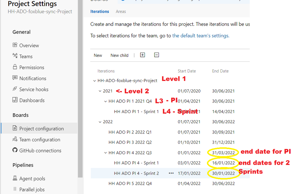

Program Increment Level Mapping: This setting is for the level that the Program Increments are set up. In a simple configuration, this should be the 2nd-lowest hierarchical level in the ADO Iteration Paths. The minimum and maximum level number should be the same (in the example below, this is set to 3). Iteration Path setup should follow the Microsoft recommended approach and be consistent across the ADO project. More complex scenarios can have different minimum and maximum levels.
Proceed with caution. If the min and max levels are set to different levels, the ADO connector will NOT create the program increments in a hierarchy in Jira Align, so manual post-configuration may be required.
Iteration Level Mapping: This setting is for the level that the Program Increments are set up. In a simple configuration, this should be the 2nd-lowest hierarchical level in the ADO Iteration Paths. The minimum and maximum level number should be the same (in the example below, this is set to 4). Iteration Path setup should follow the Microsoft recommended approach and be consistent across the ADO project. More complex scenarios can have different minimum and maximum levels.
Proceed with caution. If the min and max levels are set to different levels, the ADO connector will NOT create the sprints in a hierarchy in Jira Align, so manual post-configuration may be required.
Example of PI and Iteration Level Mapping
Buffer Days: The ADO Connector maps ADO iterations to JA Anchor Sprints based on the end dates of the iterations and sprints. Leave this setting empty for an exact match. Add buffer days eg +/- 1 days, if the JA sprint end dates don’t exactly match the ADO iteration end dates.
Adding buffer days here can cause sprint misalignment or non-synchronization. If the ADO Connector does not know which JA sprint the ADO iteration should be matched with then work items will not sync. The best practice is to ensure that the JA Anchor sprint end dates are identical to the ADO iteration end dates.
