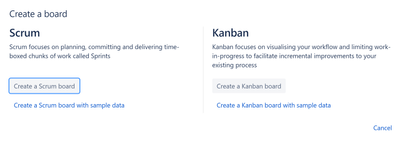

Jira Software has two types of Boards Scrum and Kanban.  You can read about the differences between Scrum and Kanban here:
https://www.atlassian.com/agile/kanban/kanban-vs-scrum

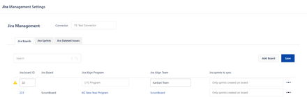

Board Integration:
After creating a Scrum or Kanban Board in Jira you can integrate the Board to Jira Align following these steps:
  1. Before mapping a Jira board, make sure that its parent project is associated with a Jira Align program. (Use the Jira Integration Settings page, accessed by selecting  Administration > Connectors > Jira Settings from the Nav menu.)
  2. Next, access the Jira Management Settings page by selecting Administration > Connectors > Jira Management from the Nav menu.
  3. Click the Jira Boards tab.
  4. At the top-right of the page, Click Add Board to create a new row of cells in the grid.
  5. Input a board ID number in the ID cell, which represents the rapid view ID from Jira.
  6. The board name from Jira will automatically populate in the Board name field once Jira Align verifies connectivity to the board.
  7. In the Jira Align Program cell, select the board’s associated program. This should match the program that the board’s project is mapped to on the Jira Integration Settings page.
  8. In the Jira Align Team field, type an existing Agile team name to map the board to an existing team in Jira Align; or, type a new team name to have the connector create the team for you as an Agile team.
  9. The project name should automatically populate from the board’s parent Jira project in the Jira Project field.
  10. In the Jira Sprints to Sync drop-down menu, select if you wish to only sprints created on the board or sprints created and shared to the board with the integration.**
  11. Click Save at the top-right of the page to save your changes.
*We recommend only syncing sprints created on the board to ensure sprints are aligned correctly from Jira Software to Jira Align. Jira Align uses placeholder sync sprints to assign start and end dates to Jira future sprints. Errant sprints shared across multiple boards will prevent the connector from making this prediction properly.
If any mapping issues occur, a yellow warning icon will appear next to the ID. Point to the icon to see the issues and actions needed to resolve them.

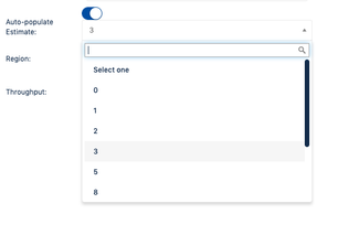

2. For Jira Align stories assigned to Kanban type teams the utilization of Story Points (LOE) will enable progress to render as data is vertically nested from the Team to Enterprise layer.  Traditional Kanban implementations call for similar sized pieces of work so it is highly recommended to define story points in Jira or Jira Align.  Currently the best method to sync Story Points from Jira to Jira Align will be setting the Story Points in Jira.
There is existing functionality in Jira Align to automatically set the Story Points field for stories assigned to Kanban type teams but it only applies to Stories created after you enable the Auto-populate estimate toggle for the team.
Enable the Auto-populate Estimate toggle in a team’s details slide-out panel to automatically apply the specified value to stories created by or assigned to the team.
An enhancement to update this functionality to Auto-Populate the Estimate for integrated stories can be found here:
https://jira.atlassian.com/browse/JIRAALIGN-955

Hina Tufail May 27, 2021
Hi @Tim Keyes , very helpful article, thanks.
We have managed to pull data with stories and now we are wanting to pull sprints + board.
I have one question that might complete this article as well : As a super admin, I cannot see the "Add board" button. I tried to set my zoom on the browser, to ask a colleague to check if this was not only me, and toggled on most of the entries for the Super admin role.
I cannot figure out why I cannot see a "Add board" button.
Your help would be greatly appreciated
Best regards,
Hina
Tim Keyes
May 27, 2021
Hi @Hina Tufail
Thank you for reaching out!  I hope all is going well.
I would guess that your Settings for Manage Boards/ Sprints are currently set to read only which would result in there being no "Add Board" button.
Please navigate to Jira Align Admin > Roles > Select Super Admin > Administration > and see if the Read Only Toggle is toggled for the three Jira Management permissions.  If it is, toggle it off, click save, log out and back in and let us know if that reveals the button.
Thank you!
Tim
Hina Tufail May 28, 2021
Hi @Tim Keyes
Thanks for your very quick and complete reply ! We actually did that, and happened that after log off/log in, the button appeared. We also created a jira align agile team (for the Story level) in parallel, to make the mapping possible.
Many thanks and have a great day ahead !
Hina
