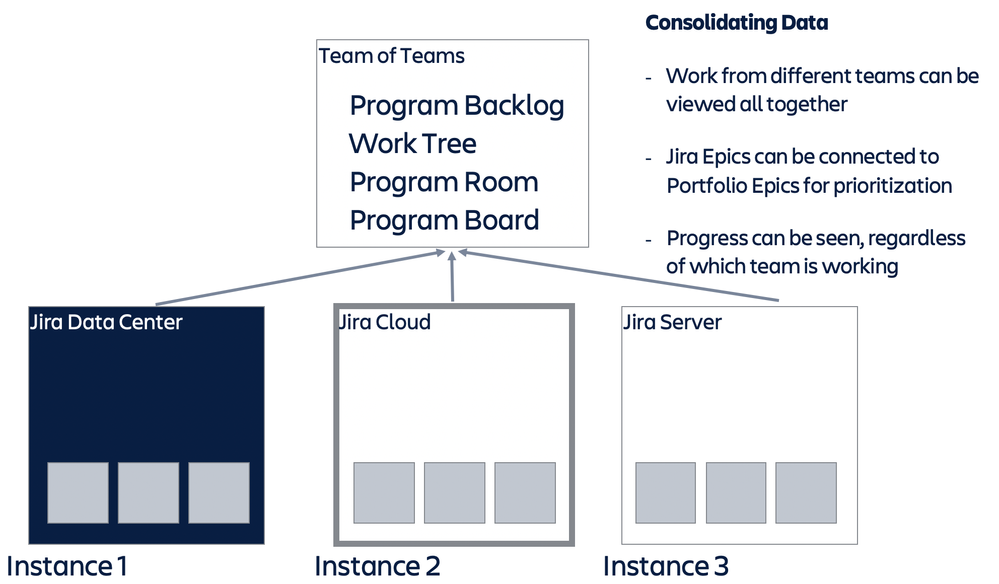

In this case, you need a separate Jira connector for each instance you want to synchronize with Align. You can combine data from the multiple instances into one single program or view them all separately. I worked with one client that had an Agile Release Train with the teams spread across 3 separate Jira instances, each with their own security restrictions.
We used 3 Jira connectors to bring the data into a consolidated view, shown below.

For anyone reading this, please be aware the information is out of date and we no longer support connecting Jira Projects from two different Jira Connectors into a single Jira Align Program. This is because sync issues were frequently seen in such a configuration
EDIT: we do support 2 or more different Jira Instances connecting to different JA  Programs with the Jira Connector you just can't connect them to the same JA program

For folks who are interested in this question: back in 2020 when this question was asked, Jira Align did support programs in different instances. However, we found there could be data synchronization issues, especially because Jira does not support the parent link across different Jira instances.
Instead, the solution is to use an issue synchronization app as @Matthias Gaiser _K15t_  suggests. In that case, you can set up a separate project to be included in the Jira Align program and use the synchronizer to take care of moving the data from the source into the copied version.
I will add an updated article to explain this and include diagrams.
THIS IS VERY DIFFERENT FROM WHETHER JIRA ALIGN ALLOWS YOU TO CONNECT TO MULTIPLE INSTANCES!
Jira Align definitely allows you to connect to multiple Jira instances. But there are special considerations that have to be addressed when a single Jira Align program/ART/Team of Teams has teams with data in different Jira instances.
