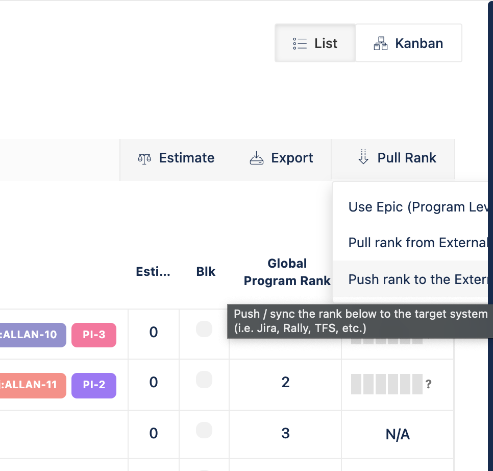

Did you press the "Push rank to External System" button?
Thanks, Unfortunately when I go to backlog at the program level with no filters set, I click the "Pull Rank" button and the only option available is pull from Epic. I went into Admin settings and "Enable Rank Sync" is enabled. Can you assist further? Thanks!

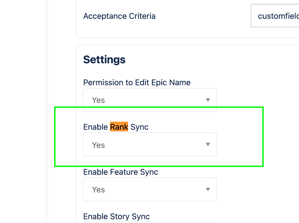

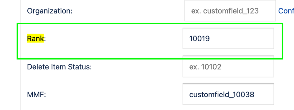

Your Admin may have to turn on the "Enable Rank Sync" and map the Jira Rank field using the field ID. Both settings are in Adimi -> Jira Settings page -> Jira Setup tab.
Allan,
First I want to say I appreciate your help! As the Admin, I was able to get this working. I used 10019 as the field number. However, this appears to be a bit of a fail as it cannot push to Jira at the team level, only the program level. Meaning, if we want to use this feature, the three team belonging to a program need to all agree on prioritization of program backlog prior to pushing to Jira.
