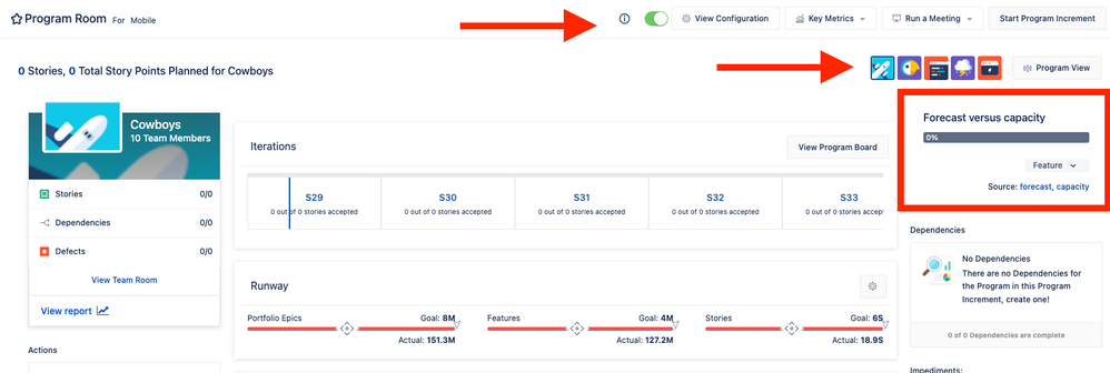

I am not fully sure, if the description mixes up capacity and effort, but I would like to point out a new gadget in the program room that might help you get the information you are looking for:
Pls visit the program room, enable the new forecast vs capacity gadget using the "lonely" toggle button:
Pls also select your team. You should find a forecast vs capacity bar showing the situation for your team only.

How can I expand on the forecast vs capacity that show at the program levelThe forecast vs capacity highlighted to the right in the image below doesn't provide useful information with the current view :|
