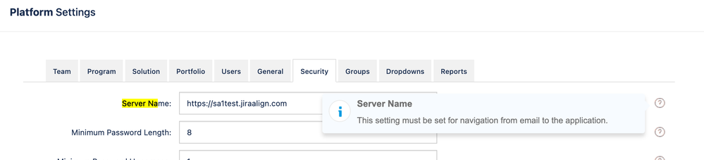

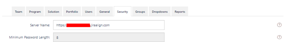

Hi Allan,
That field is populated with our [servername].jiraalign.com.
Any other suggestions?
