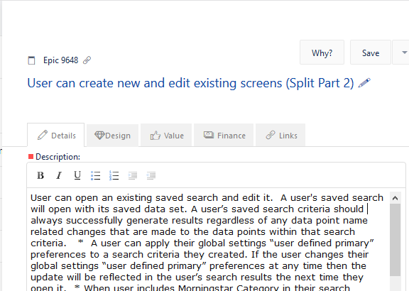

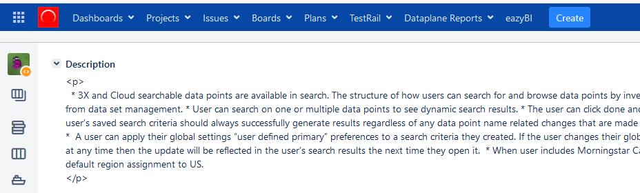

When our team members are creating Epics in JiraAlign (top screenshot), the description field is coming out badly garbled in Jira (bottom screenshot) and creating them in Jira seems to be doing the same thing in JiraAlign.

This is a known bug that has been open with Atlassian for many months and has to do with the difference in HTML Fabric Editors between Jira and Jira Align - they don't use the same one so it causes HTML tags to show up in either side and can definitely cause corruption issues.

There is a setting in Admin -> Jira Settings - > Jira Setup (tab) -> Settings (section) ->
Rich Text Format
Options in the dropdown:
None (plain text) - Recommended setting - in general - this causes no data corruption when "native" language is used in Jira
HTML - This options was developed in 2017 (ish) for use with a very specific marketplace plug in (that I no longer remember the name of) and will cause HTML "corruption" of text written to Jira instances where this plug in is not in use.
Jira Rendered field - Jira instance using Jira rendered "wiki"/HTML type font.
If your Jira Admin has not enabled the special font in Jira, AND you are not using the HTML plug in Jira this setting should be set to NONE.
Hope this helps.
I have noticed the same problem going from Jira Align to Jira but not in the reverse direction.
The field in question is straight text (and not multimedia) in Jira and when entered in Jira Align, the connector is not converting it but sending the marked up tagged version.
Irritating is that this happens on other events which change other aspects of a Jira Align entry, even when you do not edit the description.
You can see the same thing if you edit a multimedia field in Jira and then export it.

As I mentioned earlier in the post, the "HTML" option in Jira Align Jira Settings- Jira Setup - was built for use with SINGLE SPECIFIC plugin, (which I no longer remember the name of, and don't know if the developers at Jira Align still know either.)
If you are using another HTML plug in, there will be problems. Simply because they are not all "created equally" nor do they all work in the same way. As you know one can only code for what one expects to happen.
To solve this problem:
Step one: Check with your System Admin for Jira (if that's not you) to see what markup or plugins are being used.
Available options in System Admin settings and matching Jira Align settings:
*Please NOTE these are for Jira OOTB settings and will not necessarily apply if you are using a marketplace plugin for text rendering.
If your Jira environment is using "WIKI STYLE" Render for text - then the Jira Align setting under Admin - Jira Settings- Jira Setup- Field: Rich Text Format: must be "Jira Rendered Field"
If your Jira environment is using "Default text Renderer" - then the Jira Align setting under Admin - Jira Settings- Jira Setup- Field: Rich Text Format: must be "Plain Text"
If your Jira environment is using a marketplace plugin for text formatting - then the Jira Align setting MOST LIKELY to help is Admin - Jira Settings- Jira Setup- Field: HTML -
*** unless you are using the exact plugin this option was built for this MAY NOT fully alleviate the problem*****
