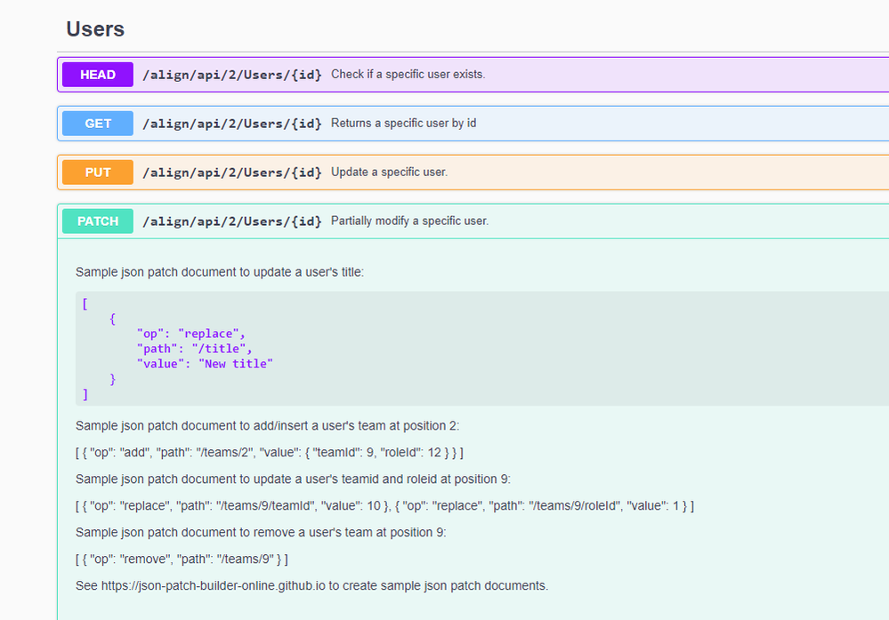

POST function will only create a user it will not update a user.
Try using PATCH instead with the relevant JSON patch document.
Check out https://your-jira-align-instance/rest/align/api/docs/index.html to see the Swagger for the Users Endpoint.
Try a PATCH request on the user id with the JSON information
"op":"replace",
"path": "/externalId",
"value": "new external id here"

Thanks for your input. I can see that I wrote wrong in the first post im using the "PUT" command. using first "get", then update the user and then "put".
I have tried using the patch function. this was succesfull:-)
