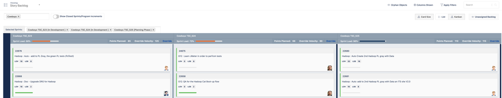

For you last question about loaded versus actual. Check out the Story Backlog -> Kanban -> Sprint View as a possible view of what you are looking for.
