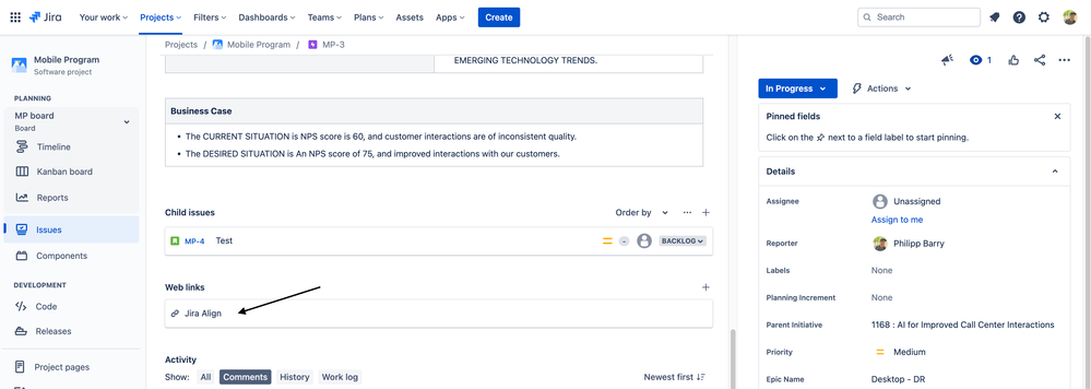

Hi Mit,
There should be a link in Jira linking to the integrated issue in Jira Align. Do you see that link?
If not, can you please (have your Jira Align admin) check what the setting "Create web links on Jira issues to Jira Align work items" in Jira Settings -> Jira Setup is set to?

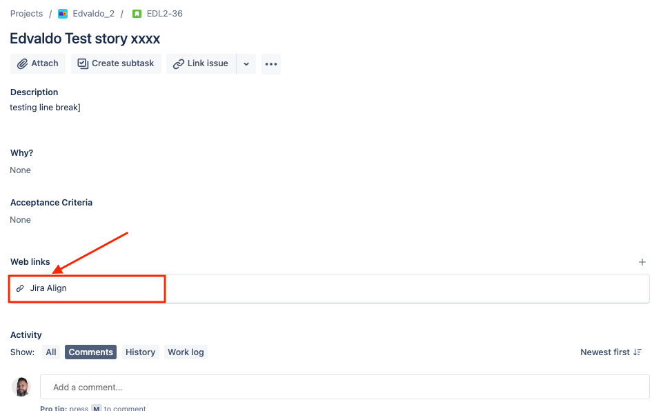

Here are the steps to find the field that will lead you to the respective JA issue.
  1. Navigate to the issues grid in Jira
  2. Select a story or Epic
  3. Click on Web Links or Issue Links depending on the version of Jira
  4. Click on Jira Align
Should still face any difficulty in finding the Jira Align link after following the above steps
feel free to raise a Jira Align support ticket by accessing this contact support.
