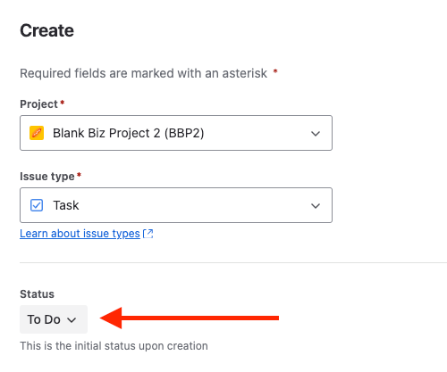

Problem
The arrows point to what they saw, which is the ability to create a ticket in the On Hold or Done statuses. This was definitely behavior that they did not want.
The reason that this was happening is that I had created a "Transition from Any Status" into these two statuses. This allowed them to place an issue On Hold regardless of its current status and to Cancel Issue from any status. However, this "Transition from Any Status"' is being interpreted by Jira as including from the pre-creation status.
Solution
Once I realized what was causing this, the solution was pretty clear. I edited the workflow to place a "Previous Status" condition on both transitions. I require the ticket to have at least been in Planning, where it should always start, before it can be put On Hold or Canceled (moved to Done).

The feature you found is a manifestation of the feature that allows users to set the status of an issue during issue creation, to any status in the workflow that has an incoming global transition.
https://jira.atlassian.com/browse/JRACLOUD-69559
You can disable this feature for the entire Jira instance by editing the System > General Configuration settings. This setting is not displayed when you are viewing General Configuration. It displays only when you Edit the settings.
