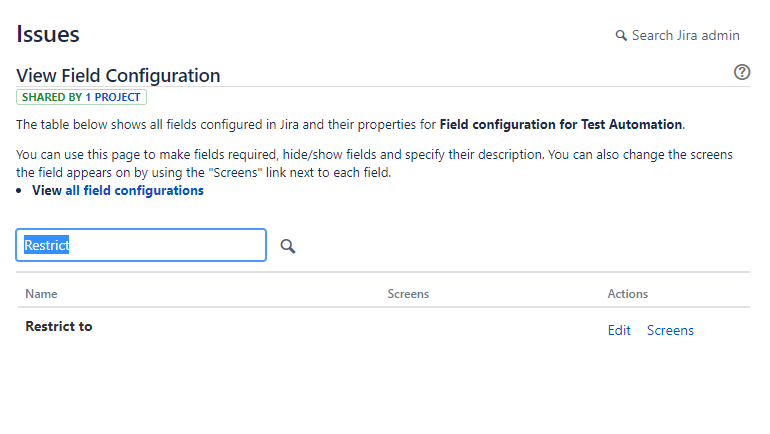

Is there any legal way to disable certain fields in Fields configuration? I am talking about these ones:
Baseline Start Date
Baseline End Date
Restrict to
I have a simple software project where I disabled all fields but Summary, Description, Attachments and Links. I tried to disable these 3 but they still show up in Field Configuration.
I know that they are used in other projects, but why Jira includes them in all projects without asking me?
As a workaround I created a context for Baseline fields where I listed only projects where they are used. But Restrict to is not a custom field and I cannot do the same with it.

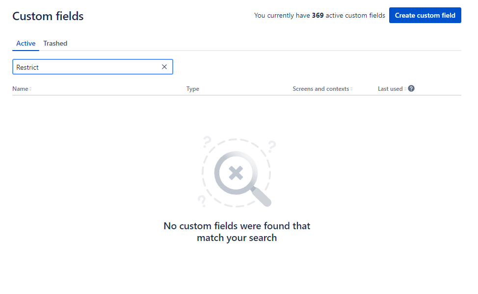

"Restrict to", as a custom field, can be hidden away from projects with the context or the field configuration.  What exactly is stopping you from doing that?

There is no Restrict to field when I search it in Custom fields. I think it is a standard Jira field.

I know that I can hide them on screen level, this is not the issue. What I am talking about is that I cannot disable them in Field Configuration for this project. There is no gui for that

The comment in the configuration is that this is required for Test Automation - I'm assuming you have a test automation plugin? So, if you remove it the plugin will cease to may stop working. If you click on shared by 1 project you can see which project is using it and if it is still required.

Well I tend to agree, I think this field was added by some plugin. Is there a way to restrict plugin to certain projects so that it does not interfere into normal work of Jira? And the second question - is there a way to find which plugin created the field so that I would uninstall it or write to developers to fix it?
Linda Milne_Togetha Group_
August 24, 2021
I don't believe you can restrict plugins per project, as such - you can use groups or other config to restrict user access to it.
Ive just had a look at my field configurations and I too have a Restrict To config in one instance, but not the other. Cant identify what plugin it might be linked to. Is it an Access / SSO thing? The big difference between the two instances is the Microsoft Teams plugin - could that be the source?
