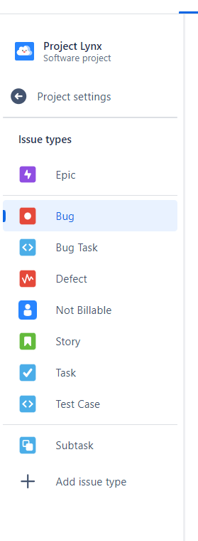

Hello!  I am trying to add a sub task called subdefect to a project.  I added it in the issues area in administration,  but I can't see it in the project.  What am I doing wrong?  It's a team managed project.

Gary Spross
September 12, 2024
@Clare Lawson, currently, Team-managed projects only allow you to add "standard" issue types. See this post: https://community.atlassian.com/t5/Jira-questions/I-am-trying-to-add-a-sub-task-issue-type-to-my-team-managed/qaq-p/1892862.
I just checked within my instance and, as far as I can tell, this is still the case.
Ari Raatikainen
September 12, 2024
Agree, hierarchy of issue types cannot be modified in Team Managed projects, so creating any new issues type is treated similar to task.

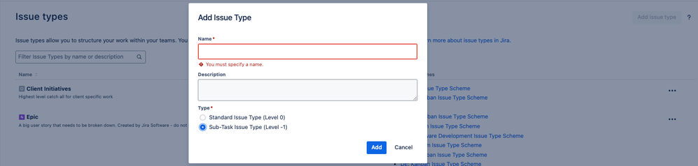

Andrew H September 12, 2024
I'm on a company managed project, but when I went to Jira Settings > Issues, then clicked "add issue type" (top right of screenshot) the popup menu allowed me to add a subtask type. I'm a relatively new Jira Admin so not sure how other settings would impact this, but hopefully it helps a little.

Clare Lawson
September 12, 2024
Thank you.  I can make it an issue type but I wanted it to be a subtask, not a regular issue.

Brian Selewski
September 16, 2024
Team managed projects are limited to the issue types created within the project itself, if you create an issue type at the Jira admin level, it will only be available for company managed projects.  Same goes for custom fields, Statuses, etc.  Anything in a team managed project is limited to what you have in the project itself, system settings won't be available.
The team managed project comes with a Subtask issue type that you can update the name to Subdefect if you would like, but the Team managed projects will not allow you to create a different sub task issue type.
