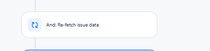

Hi Suneel,
Try with Re-fetch issue data.
Hi @Madhuri Latha Bhumireddy ,
The trigger " Re-fetch issue data" ,
Where we have to use in both the rules & How we can set it up ??
Suneel babu

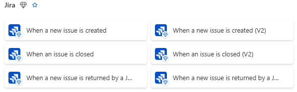

I've used Power Automate to create new stories in Jira - not sure if that's the app you're using, but depending on what your process is doing, there may be a small triggering effect there that could fire another flow here, to start another flow simultaneously
Here are some of the available triggers I can see (may differ for everyone)

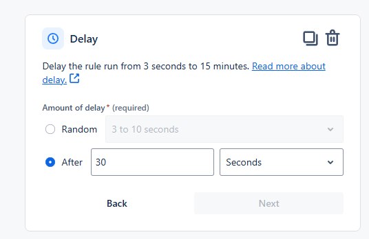

Hi
When i had same 65 Component limit, then i create two sepparate Automation for solution. I use time wait for one automation run, then after later another will run also.
Urmo
Hi @Urmo ,
Thanks for your response,
Can you pls elaborate a bit, what you have done with this "time wait"
Suneel Babu
I do not think this is possible as the Automation rules kick off in random order. This would be nice though to help make sure things happen in a specific order.
I suppose you could set a field to a specific value and then have that one trigger the next one. You could use re-fetch for the action to update, etc.
