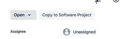

Hi Vanessa! We do a combination of everything mentioned, as well. I created a global looping transition on the workflow in my JSM project that has a post function that copies the issue to the software project and links the two issues.
Because they are linked, I am able to trigger a handful of automations to keep statuses in sync, update fields and copy comments over, if needed.
Looping transition:
Automation syncing statuses:
(The software project has a more complex workflow, so multiple statuses map to one JSM status).
