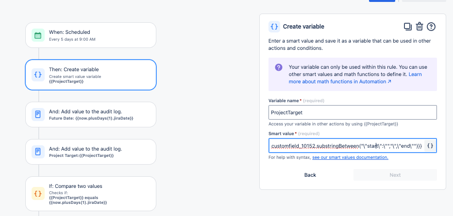

1) WHEN: Scheduled (select when this automation should be scheduled to run)
2) THEN: Create variable
  • Variable name = TargetDate (or anything you like)
  • Smart value =
{{issue.customfield_XXXXX.substringBetween("\"start\":\"","\",\"end\"")}}
  • ^ customfield_XXXXX would be the custom ID of your JPD date-field
*3 / 4) These steps can be disregarded, and were simply used for logging purposes to troubleshoot and debug throughout testing
5) IF: {{smart values}} condition (aka "Compare two values")
  • First value = {{TargetDate}}
    • ^ This would be the variable configured in step 2
  • Condition = equals
  • Second value = {{now.plusDays(5).jiraDate}}
6) THEN: Send Slack message (or email user(s) / preform some other action)
Step 2 converts my JPD Project target field from a range, into a variable with the formatting of yyyy-mm-dd. This is done using string processing.
Step 5 then compares the variable to the present date + 5 days from now (future date so to speak), and if these two dates match - the automation sends a message to Slack.

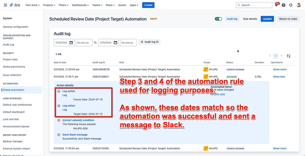

Here is the Audit log tab of this automation through some testing:
I'm not sure this is the "perfect" way to do this, but I hope it helps and can reference when configuring your automation!

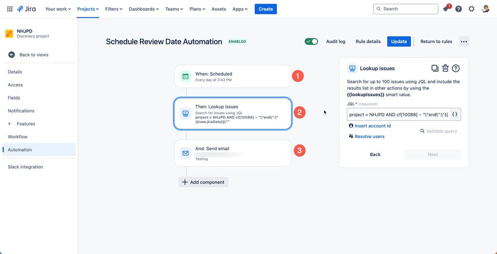

We were able to get this resolved through a support ticket using an automation like the one below - which can send a daily email of all ideas if their JPD date-field matches the present day:
1) WHEN: Select schedule for automation to run
2) THEN: Lookup issues - JQL:
project = XYZ AND cf[00000] ~ "\"end\":\"{{now.jiraDate}}\""
 ^ cf[00000] is the JPD date-field's ID. Can find this using this doc:
3) AND THEN: Send email - which uses the Lookup issues from previous step to list all ideas in email body using this:
{{#lookupIssues}}
* {{key}}, {{summary}} - {{url}}
