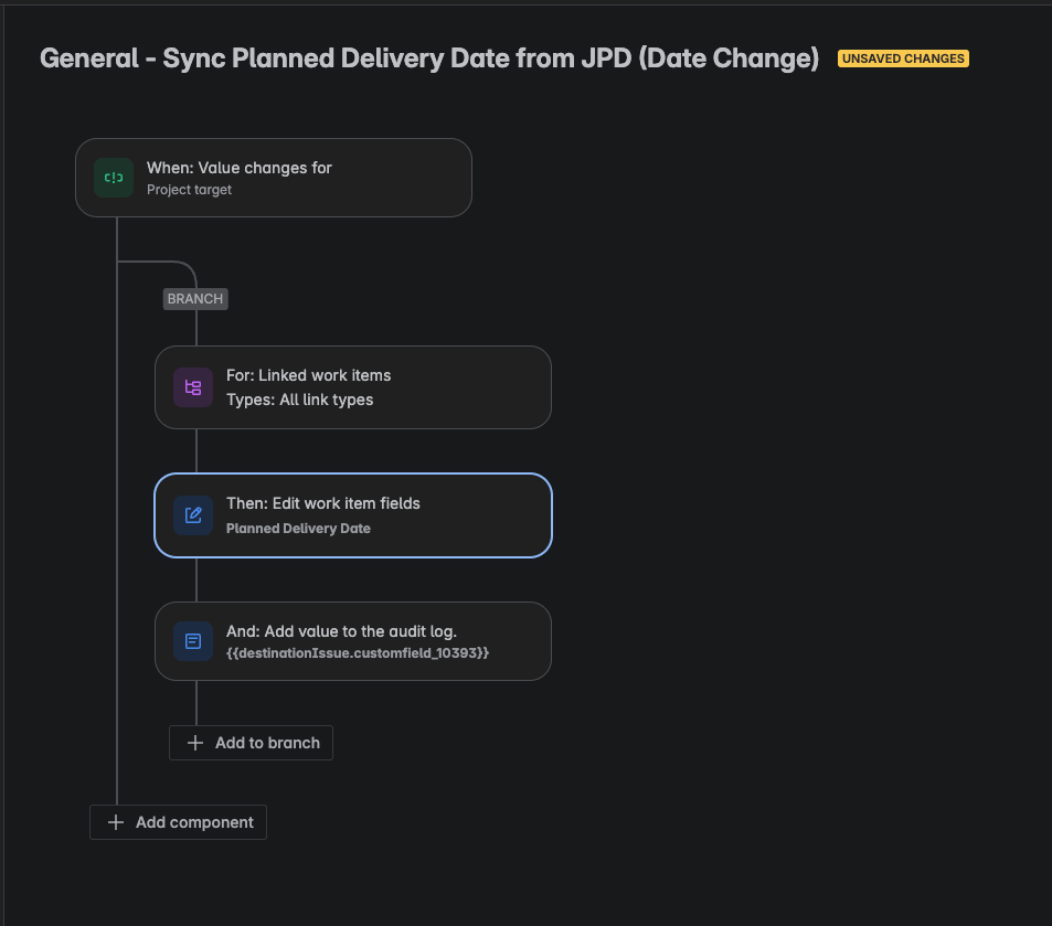

Hi Community,
I'm trying to sync a "Planned Delivery Date" from a JPD field to a linked Jira Epic.
My Setup:
  • Automation Rule triggers when a JPD Idea is linked to an Epic.
  • The rule is configured to edit the linkedIssue (the Epic).
  • I'm pulling the value from a JPD field (customfield_XXXXX) whose value, according to the API, is a JSON string (e.g., "{\\"start\\":\\"...",\\"end\\":\\"..."}").
  • My Smart Value for the date is: {{triggerIssue.customfield_XXXXX.jsonParse.end.jqlDate}} (intended to parse the JSON string and extract the date).
  • I'm writing the value into a Debug Text field on the Epic.
The Problem: The Automation Rule shows SUCCESS in the Audit log, but the Debug Text field on the Epic remains empty. The JPD field is populated, IDs are confirmed, and the rule structure is set to linkedIssue.
Question: Why isn't the Smart Value (with jsonParse) resolving to a value, or why isn't it being written to the field? Any debugging ideas would be greatly appreciated!

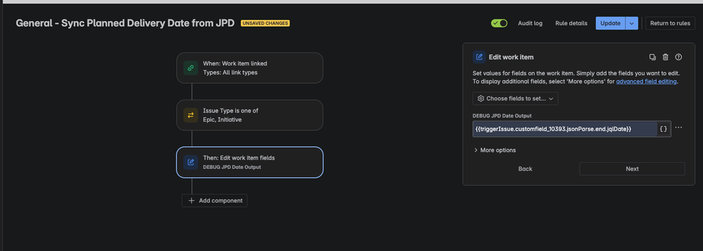

Sebastian Pechhold
May 23, 2025
Hey @Bill Sheboy ,

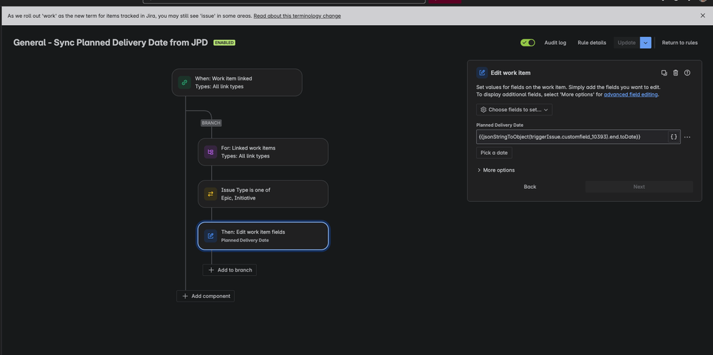

thank you. I changed the setup:
To answer your previous question. Yes, i used Gemini before i got here :)
Project Target field (JPD) is not empty. It has a single date or a date from/to (mostly quartery)
Date format month June:
{\"start\":\"2025-06-01\",\"end\":\"2025-06-30\"}
Time frame format Q2 April-June:
{\"start\":\"2025-04-01\",\"end\":\"2025-06-30\"}
it is always the same "string" in postman.
Goal:
Transfer/sync this date to the linked epics/initiatives.
With my current setup, no actions were performed.

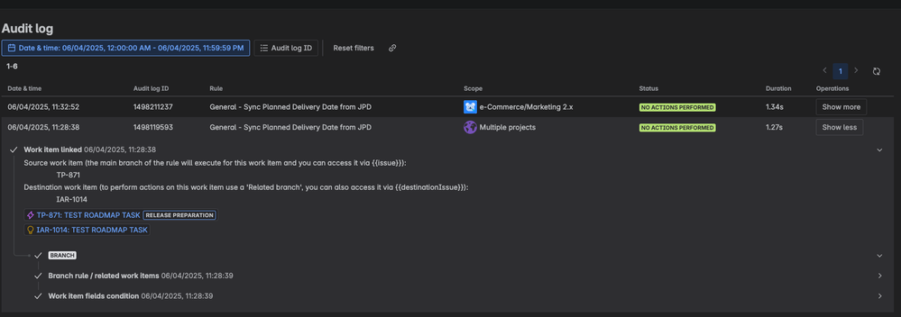

Thanks for your patience. I just linked an Epic to the idea. Nothings happens.

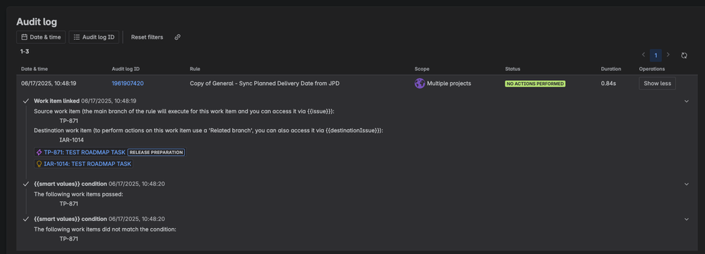

Bill Sheboy
June 4, 2025
At the right side of the log for those entries expand the details with the arrow > icon, and re-post the image.
That will show the issues involved and possibly indicate why this is happening.  For example, if the trigger issue is not an Idea, then you may not be finding the correct ones inside of the branch...leading to the condition to not match.
Triggering a rule on Work Item Linked is tricky, because no matter to which issue the link is added, the "trigger issue" is always based upon the direction of the link type.  Please see this great explanation from @Trudy Claspill on the topic:
https://community.atlassian.com/forums/Jira-questions/How-can-I-get-field-from-linked-issue/qaq-p/2807497#M1050229
Like Trudy Claspill likes this
Sebastian Pechhold
June 5, 2025

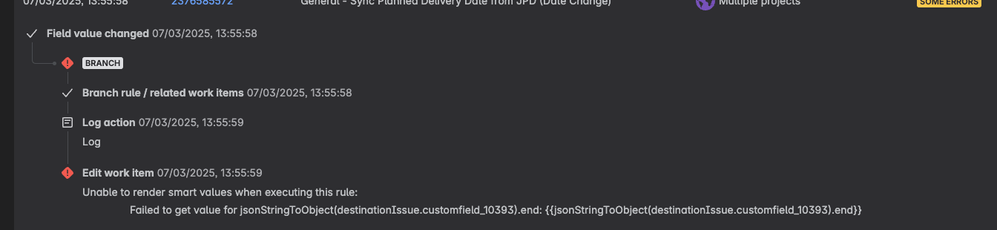

It seems that rule is being triggered correctly. But the field is not mapped.

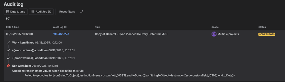

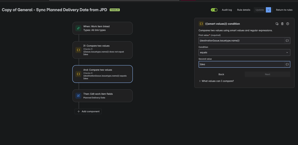

Bill Sheboy
June 6, 2025
I just retested to confirm the behavior based on the link direction noted earlier:
When a "delivery" work item is linked to a JPD Idea, and the rule trigger is Work Item Linked...
  • the trigger issue is the "delivery" work item
  • the destination issue is the Idea
This happens regardless of where the link was added: from the Idea or from the "delivery" one.
As your rule is written, it assumes the trigger is the Idea, which is reversed from what happens.
To update the "delivery" one with the data from the Idea's date field, please try this:
  • trigger: work item linked
  • smart values condition:
    • first value: {{issue.issuetype.name}}
    • condition: does not equal
    • second value: Idea
    • first value: {{destinationIssue.issuetype.name}}
    • condition: equals
  • action: edit work item
    • setting your date from the destination issue's smart value...
{{jsonStringToObject(destinationIssue.customfield_10393).end.toDate}}
In that first Smart Values Condition, I generically tested the trigger one for "not an Idea".  You could change that to use the Field Values Condition to specifically test for your desired issue types (i.e., Epic or Initiative).
However, please note well: if you are using team-managed projects to link to Ideas, the types will vary by project.  So perhaps use the type name to be certain of matches.
