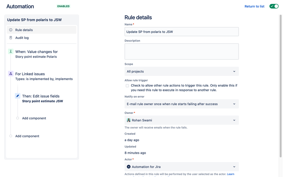

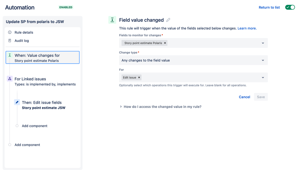

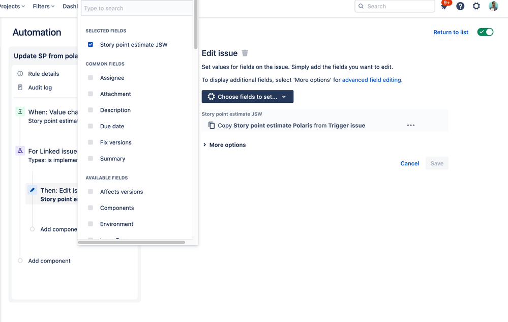

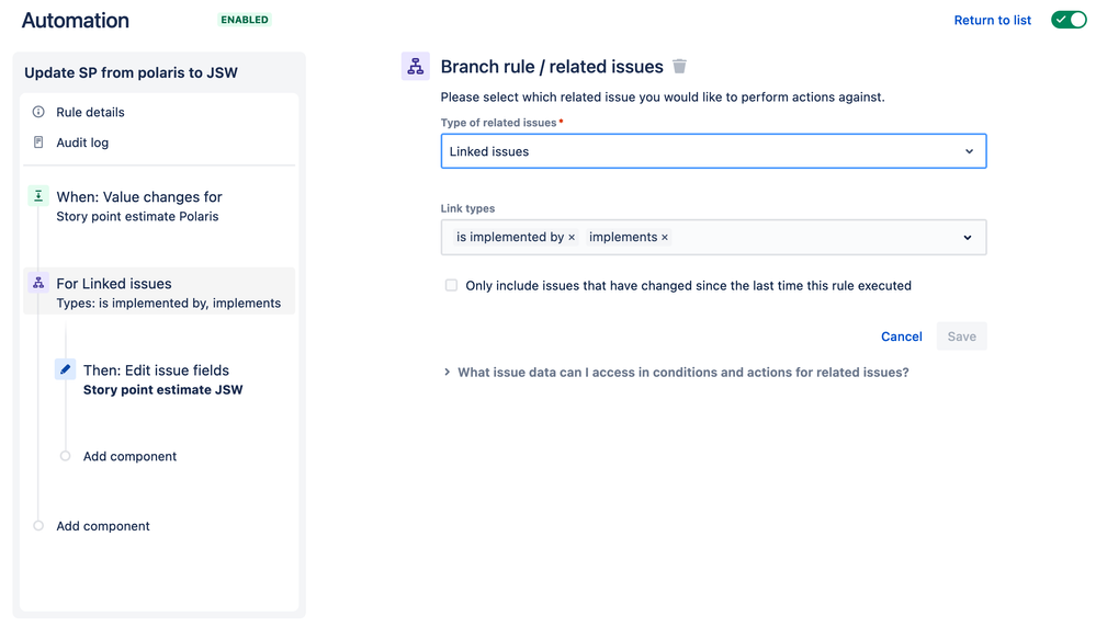

For those following along in the Community, below is an Automation example for copying Story points from a Discovery Project to Jira Software. Note that the Story Points field is incompatible with Automation so I've created a custom field called Story point estimate JSW.
@Rohan Swamithe images don't show. Could you check?
thanks @Jan-Hendrik Spieth i've reuploaded it should work now.
hi @Hannah Garvin - I'm trying to update the other way (i.e. I have an Epic linked to a RDP Idea (implements/implemented by) and can't get it so that when I update my Story Point Estimate field in my Epic that it updates a RDP Idea Story Point Estimate Total (Custom Field).
Do you have a view on how this might work (i.e. would it just be reversing your automation perhaps using the 'Parent' instead of 'linked issues'?)
