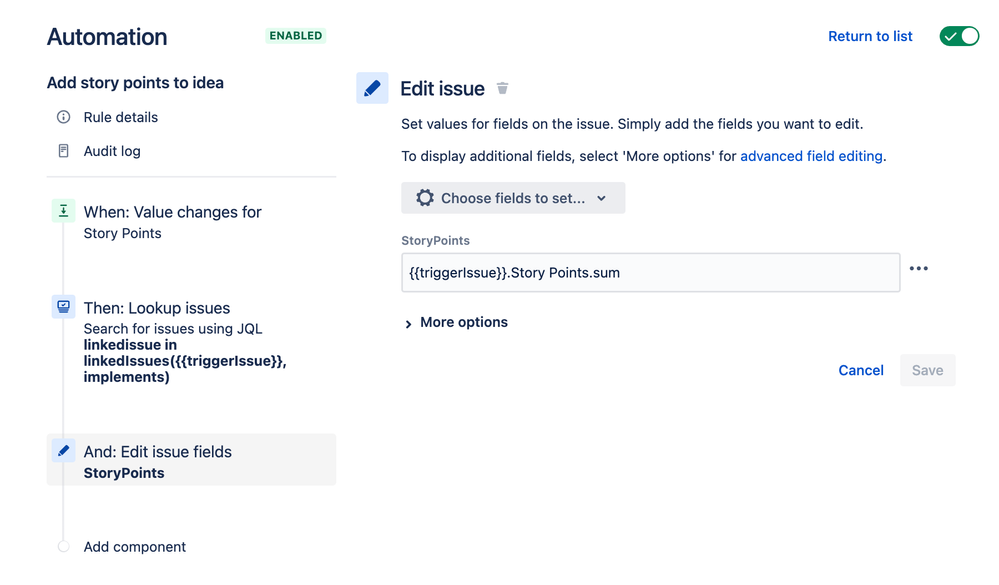

1. I would like to have the story points of the tasks that 'implement' the product discovery idea task added to said task under a new integer property i called "StoryPoints"

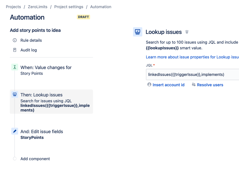

2. Below is the automation I am trying to build, however I cannot fetch linkedissues of the trigger issue with type implements
linkedIssues({{triggerIssue}},implements) does not work

Hi @ABD ,
Shouldn't your query be:
linkedissue in linkedIssues({{triggerIssue}}, implements)
This seems to work for me if I replace the smart value with an issue ID
ABD September 7, 2022
@Chris Timms thanks for your reply. This fix worked and I see that the automation is indeed able to find the correct `implements` issue from the trigger issue.

This is how my third step looks

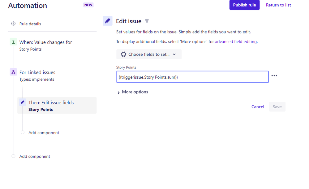

Chris Timms
September 7, 2022
Your automation is trying to edit the StoryPoints value on ZL-3508 which doesn't exist because StoryPoints only exists on PM-58.
On reflection, doing something like below is a little neater than relying on your original JQL:
ABD September 8, 2022
@Chris Timms Thanks for this suggestion, I implemented it and it works great!
