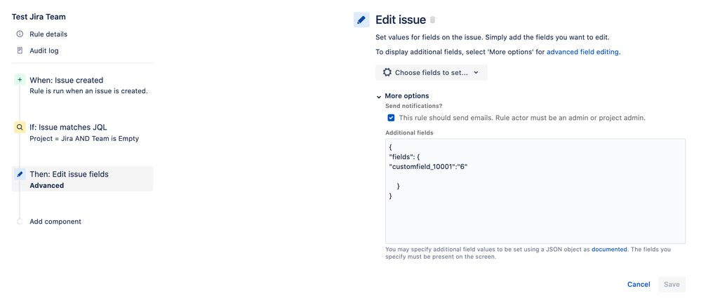

As the idea is to automatically update the Team field when an issue is created, we can set up a pretty simple rule with 3 components:
As this last step is the key to the entire automation, I'll dig in a bit deeper into the logic and decompose the code:
"fields": {
"customfield_10001":"6"
Make sure you don't forget the { { } } in your code here, as they make sure everything is interpreted correctly by the automation engine.
Apart from that, all you need to do is fill out the custom field ID from the Team custom field and the numeric identifier of your team you retrieved earlier.
