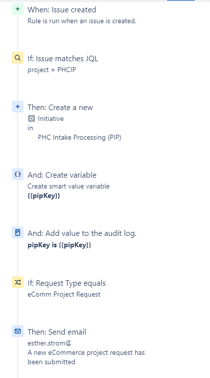

Right now, perhaps you are thinking: "Which variable type will be set when we create a component like a variable?" I would like to point out that this variable will be a String type.
We have created a rule to show that the Issue key SD-7 was the trigger that returned from that JQL. Then we will be able to set the variable as the result of the Branch JQL that is the issue CK-159. Through this variable, we will be able to access the value out of the branch.
Audit log result:
