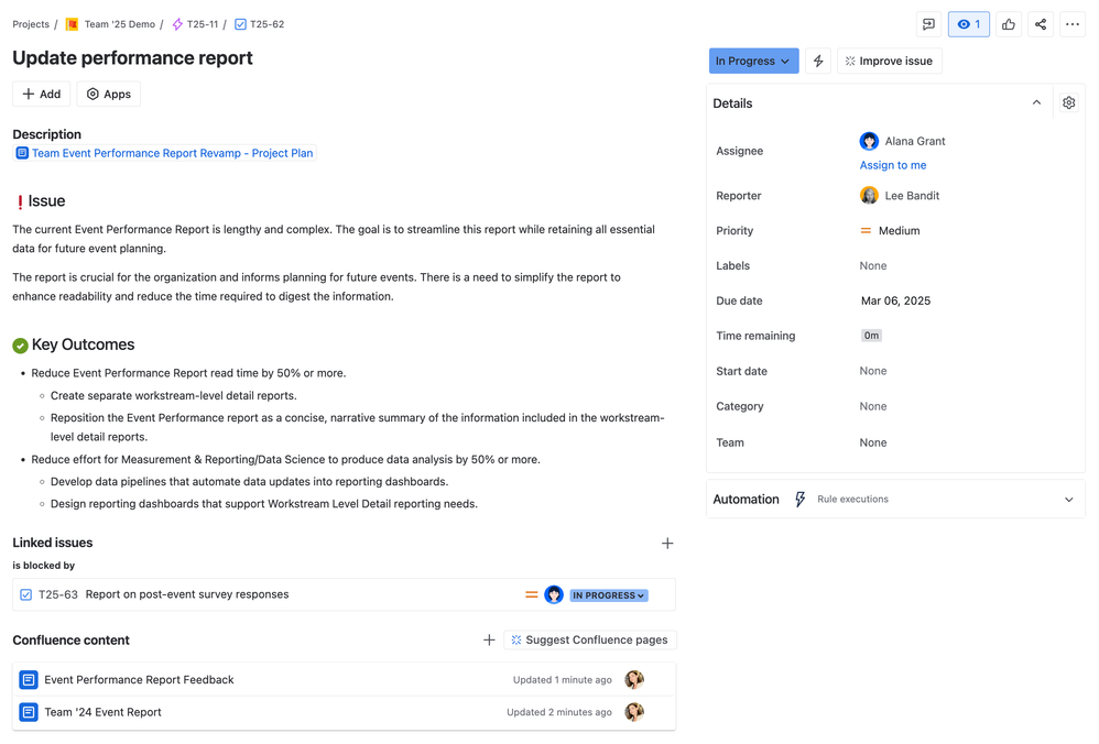

To prevent information from slipping through the cracks, the team took full advantage of detailed task views to provide context and cross-link as much as possible.
  • Task descriptions: What is this task? Who are the key players? What are the key things team members need to know? What Confluence pages should they read to learn even more?
  • Linked work: What tasks are related to this one, whether it’s more of an FYI or a dependent relationship?
  • Attachments: What are the key resources that are relevant to this task?
  • Comments: Async questions and updates between team members should happen on the task itself instead of in multiple other channels
While the team is still adjusting to these new habits in Jira, they’re finding the benefit of having everything in one source of truth really makes a difference. For example, when they’re ready to kick off planning for Team ‘26, everything will be right there for them — no need to chase down any information through pings and meetings. They’ve set themselves up for success for all future events.
