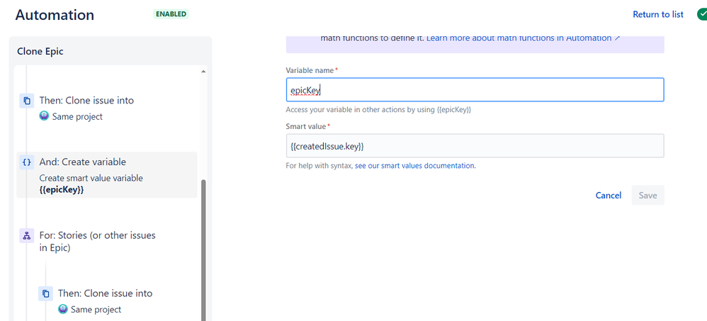

Thanks for writing this Automation Rule, I implement the first part (We have no Sub-Tasks) it clone new Epic,It clone new Stories BUT separat, and the new Stories are not under the new Cloned Epic, Do you have any Idea, how can I solve it? Thank you in advance!

@Jorge HIn my case, tasks are being cloned but I can't link them to a parent, they are left loose in the project. I can't put in the Epic link as EpicKey because this is not an intelligent field, the same thing in the parent field. Both fields ask to select predefined values and do not accept a JQL. What would be the alternative in this situation?

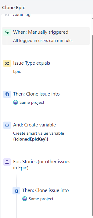

Hola @Jorge H , quiero realizar esto en mi jira pero no tengo la opcion de Clone epic a la hora de crear una regla, es posible hacerlo de otra manera? A continuación te muestro los desencadenadores que tengo:
El desencadenador tiene que ser manual como se muestra en la segunda imagen del post original.
El desencadenador manual sirve para llamar la ejecución de la regla dentro de alguna incidencia y tomar esa incidencia como referencia para todos los smart values usados dentro de la regla.

I'm noticing that the child issues did clone but they did not go under the right epic. They went under the master epic, instead of the epic that I just built.
The master epic is Me2-11 and I wanted them to go under Me2-295
