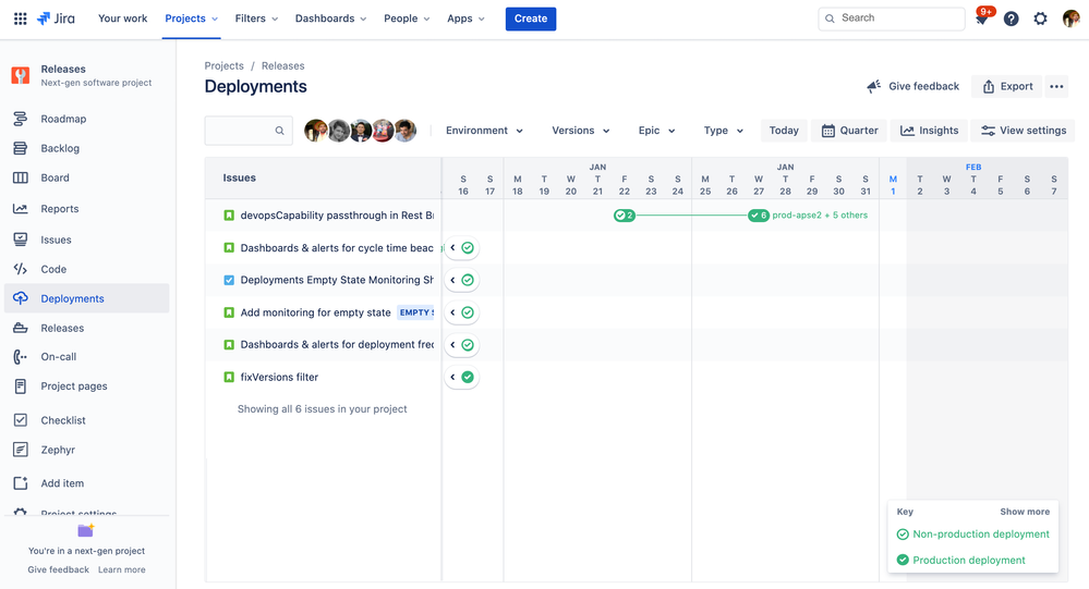

I am a real big fan of the Deployments timeline (and its underlying API) provided by Jira Software Cloud. In this highly practical post, I want to share our findings and some of our recipes with you.
Deployment is a vast area. Depending of the context it may serve different purposes. Atlassian provides very cool tools to share deployment information in Jira Software:

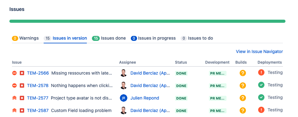

This gives you a global view of the tickets that have been recently deployed to your various environments on very handy timeline:
This view is really useful to find the tickets that have been recently deployed to your various environments.

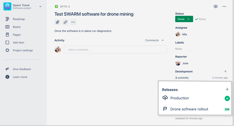

Jira Software provides also an easy way to access the deployment status of an issue from its “Development” information tab:

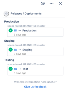

The last deployments of an issue can now also be accessed directly from the “Releases” page:
