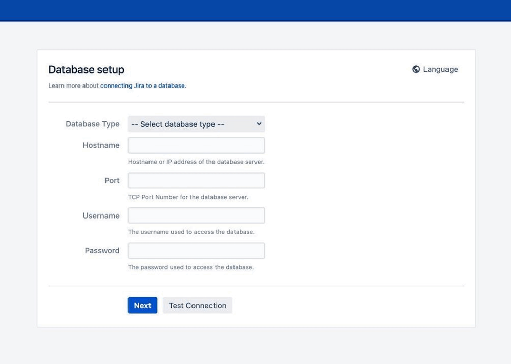

Your Jira setup wizard guides you through the configuration process. To begin, access your new Jira instance via a web browser after completing the initial deployment.
Note that the fields displayed on this screen are identical to those on the Jira configuration tool.
If you're connecting to your own database, select Test connection to make sure Jira can connect.

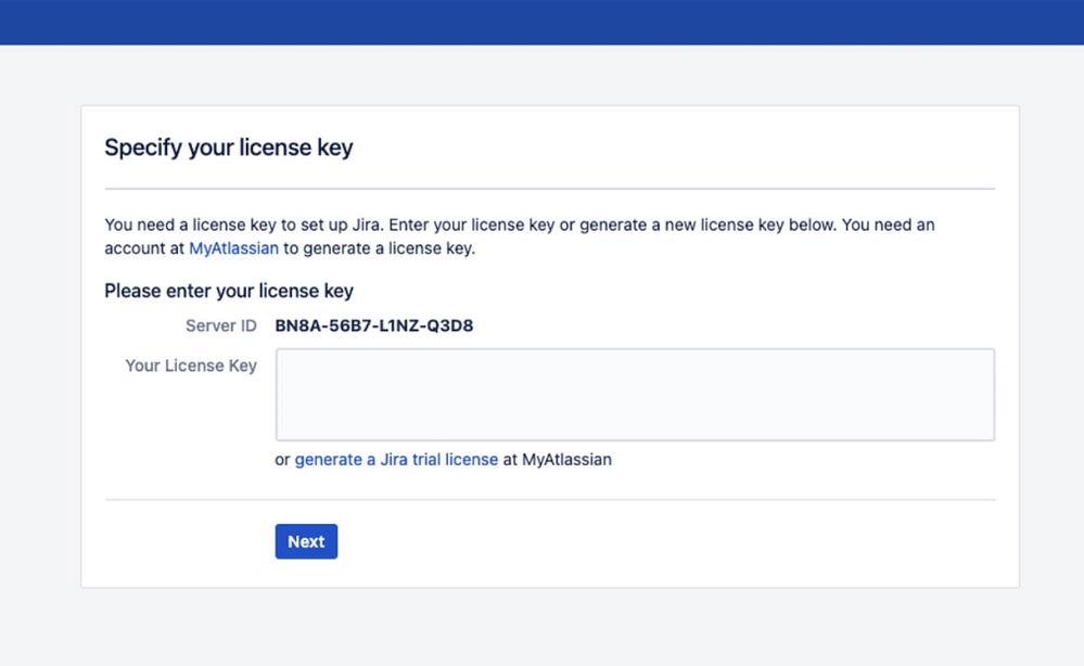

Use Atlassian's Developer License portal
This step ensures the test instance remains fully functional while complying with Atlassian's licensing requirements for development and testing purposes. The license grants access to all features needed for thorough testing and development work, while clearly differentiating this from a production environment in terms of both usage rights and system capabilities. (For more details, check Running the setup wizard.)

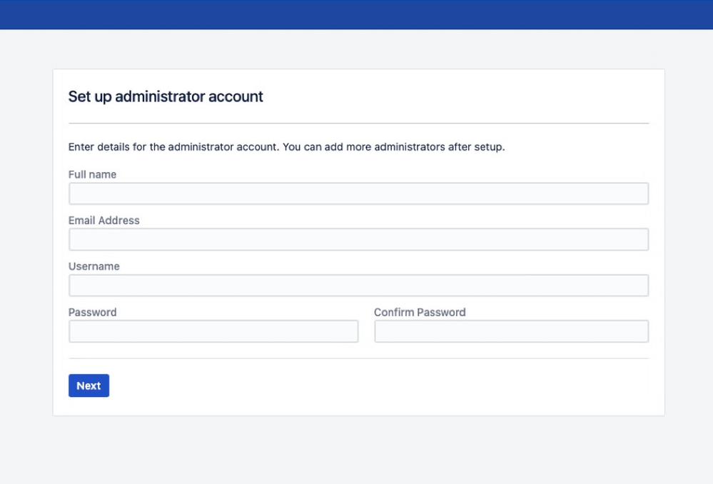

Set up the administrator account
Enter the details for the administrator account for the installation. The account will be granted the Jira system administrator permission. You can create additional Jira system administrator and Jira administrator accounts after you've set up Jira.
