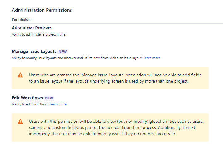

So, you’re thinking, why don’t I just always create CMP projects then? Great idea! But what’s the ramifications of that? Most notably, unless you are a Jira Administrator for the organization, you won’t be able to create the project at all. You will need one of your Jira Admins to do that for you.
Oh, and you want to change the workflow or add a totally new custom field? You’ll need the Jira Admin to do that for you, too. This frustrates a lot of people and, in my opinion, is the number one reason that Team-managed projects get created.

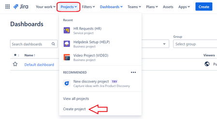

How Do I Create a New Project?
It’s pretty straightforward. Click the Projects menu option in the top navigation bar and then select Create project

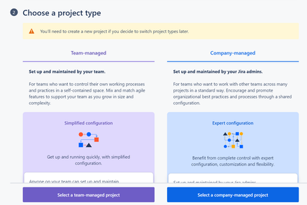

Beware the Big Sneak!
If you choose Software development and continue on that path, Atlassian makes it very obvious that you need to choose between Team-managed and Company-managed projects for your type.

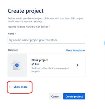

However, if you choose one of the non-Software templates, Atlassian has sneakily defaulted the project type to Team-managed!! Using our Finance template example, we land on the Create project details page and all looks good.
But if you simply fill in the information for the visible fields and click the Create project button, you will get a Team-managed project. That’s because the place to choose the types is hidden under the Show more link. Also, note that if you want to choose your own Project Key for a project, you will need to click the Show more link.

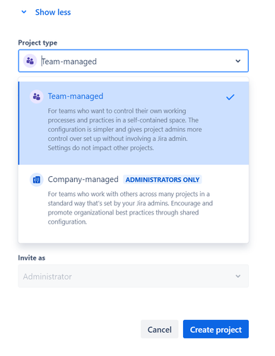

Clicking on this link opens you to the world of the Company-managed project.
Here, you will need to click on the option for Company-managed ADMINISTRATORS ONLY block to create a Company-managed project. It is unknown why Atlassian has implemented project creation as such, but you can draw your own conclusions.
