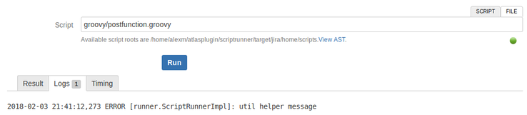

Just for the sake of simplification we will not change any workflow to run the post function. We will execute the script from the Script Console:
We can see the message from UtilHelper.groovy file. It worked.

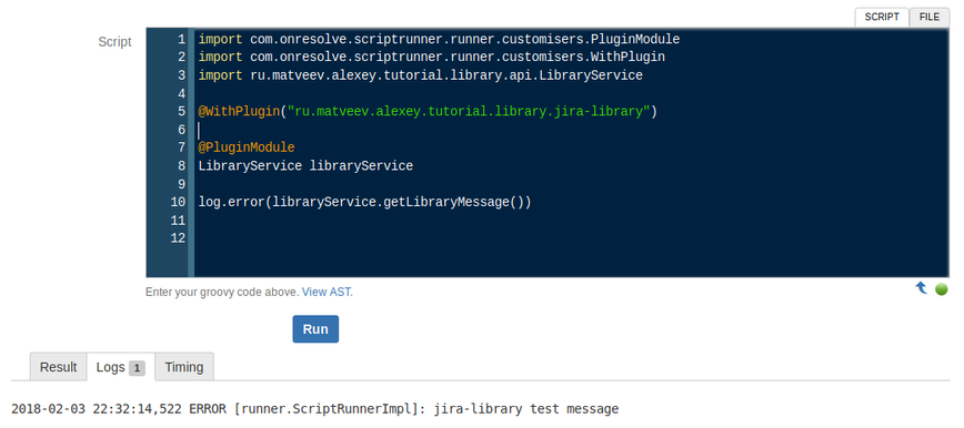

Keeping this in mind we open Script Console and write the following script:
import com.onresolve.scriptrunner.runner.customisers.PluginModule
import com.onresolve.scriptrunner.runner.customisers.WithPlugin
import ru.matveev.alexey.tutorial.library.api.LibraryService
@WithPlugin("ru.matveev.alexey.tutorial.library.jira-library")
@PluginModule
LibraryService libraryService
log.error(libraryService.getLibraryMessage()
And after we run it, we will see the message from getLibraryMessage() function of jira-library:
That is it. It worked.
