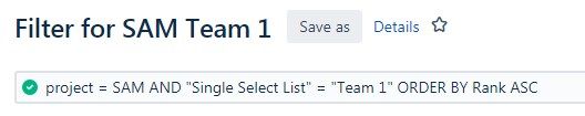

The best way to do this would be create a custom field of type Select list (Single) to separate Team 1 and Team 2, then while creating issue select which team the issue should be assigned by selecting the field.
Now to separate the Team 1 issue and Team 2 issue you have got the field.
Then create two boards with JQL saying
as [project = "" AND field = "" ORDER BY Rank ASC] for the board filter, where in field value changes.

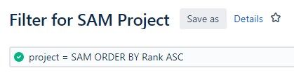

Now if want to create the common backlog for both teams, Let the Original board when you have created the project be the same and follow the first answer I have mentioned.

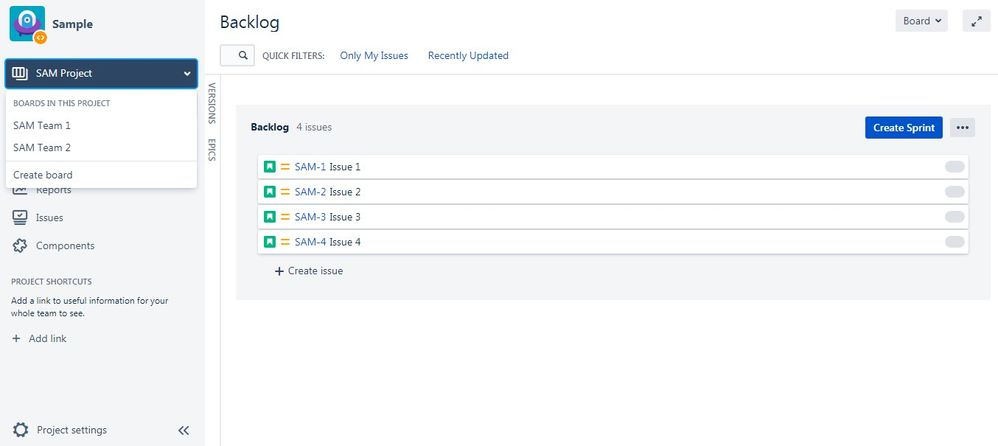

So you would have three boards on with the filter [project = "" ORDER BY Rank ASC] with no sprints in it, whereas the other two boards would have their respective teams filter in their boards and track their issues !
Hope this helps !

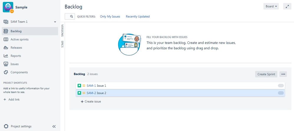

Here is the format of how it looks
This is main backlog
This is filter for Main Backlog

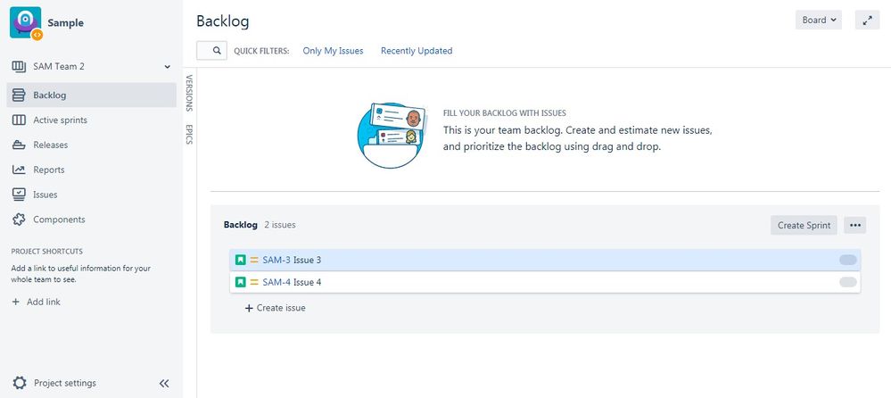

This is Team 1 Backlog, where in you can also track Team 1 Sprints.

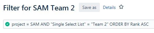

This is Team 1 Filter
This is Team 2 Backlog
This is Filter for Team 2

@Pramodh M How did you get the two boards? I don't need to filter in the product backlog between teams, I just need to be able to create two sprints (sprint backlogs).

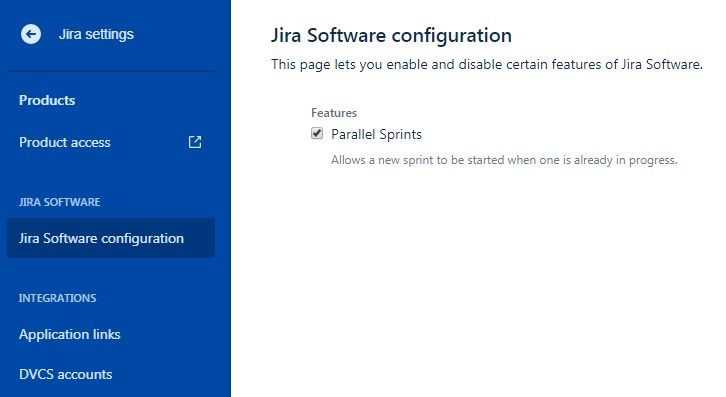

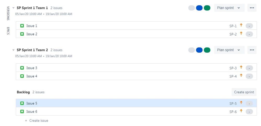

You need to have the parallel sprints to achieve this, follow the link for more info
https://confluence.atlassian.com/jirasoftwarecloud/using-parallel-sprints-797737030.html
Go to Jira settings page in that products page and in that enable parallel sprints
Here is the parallel sprint configured for Team 1 and Team 2
And the board would show all issues of all teams.

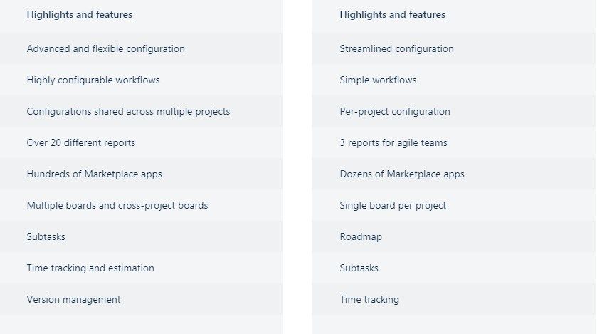

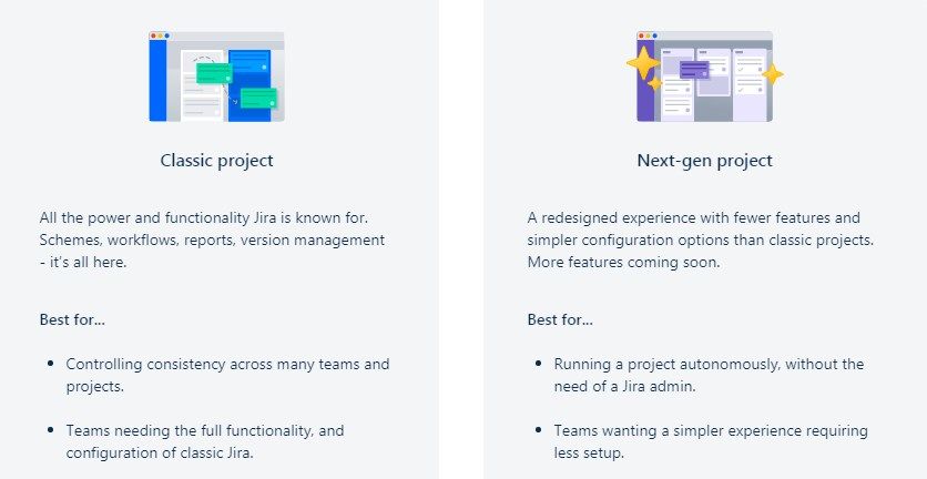

Here's the difference between classic projects and Next-gen Projects.
What you can do is get the Jira Roadmap Plugin (Some of them are Epic Roadmap for Jira Software, Easy Agile Roadmaps for Jira) if Roadmap feature is important and use the classic projects to extend features.
Next-gen Projects are made for small teams with different sets of goals...
Here is the link about Next-gen Projects.
There are so many limitations in Next-gen Projects for bigger teams.
