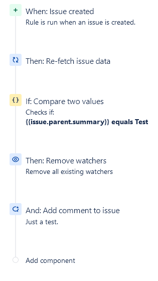

It looks you did things right but were running into a timing-issue. I reproduced it and fixed it the following way:
You would need to tweak the rule according to your environment. I not fully understood why you are removing watchers, or, in other words where they were set so removing in my case did not make any sense. Anyway, I inserted the action to make it more look like yours.
Please check if this helps.

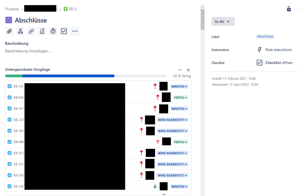

Here is a simple filter which shows I can't even select any other option than "No Epic Link" when filtering for it. The empty column on the right also doesn't return the right epic of which we have two. We use these epics as constant swimlanes to differentiate two major processes. An issue moves through the statuses in the first epic and after a few months through the same statuses in our second epic. So all our issues are part of one of these epics. None of them show up in my filters and don't return any results in my rules though.
Here you can see an example issue with its epic.
Here you can see one of those two epics and all its subsidiary issues.

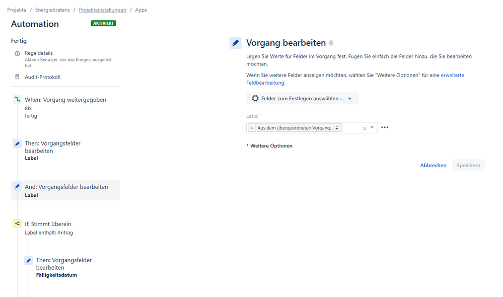

And while writing this I remembered I was able to adress the epic with one rule and no others. Here is the rule which gets triggered when an issue is moved to the Finished column. The rule then deletes any labels and in the next step copies the label of the parent issue (übergeordneter Vorgang in German) to the issue which triggered the rule.
I don't understand why this works here and not in other rules. And I don't understand why the next if-check (label = Antrag) doesn't trigger anything after the previous step clearly copied that label into the issue.
