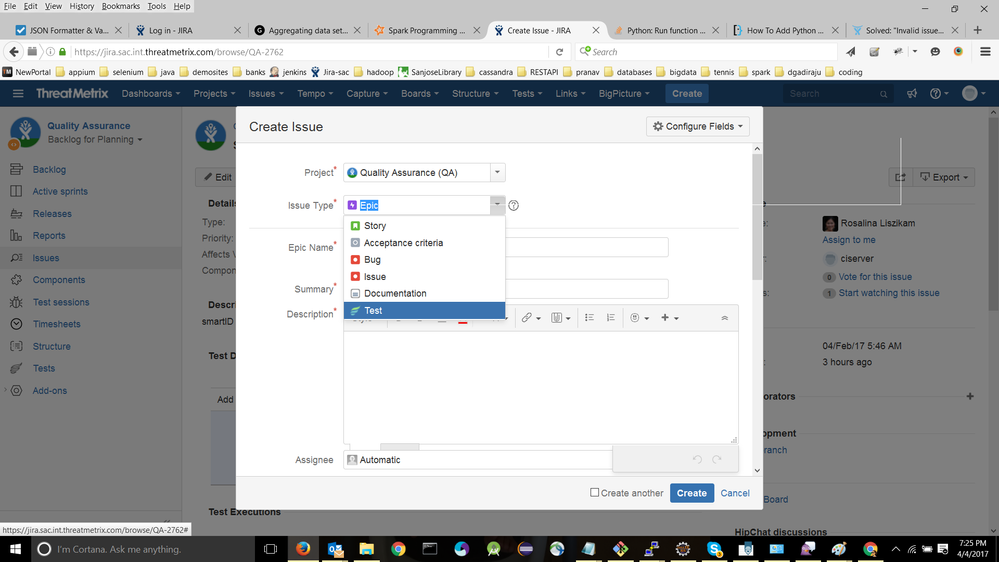

srinivas nayani April 4, 2017
please look at the issueTypes in the image below. There is issue type called "Test" in "QA" project. Please check if something is wrong..
thanks
Ron Gates
April 5, 2017
Instead of operating on names I recommend to operate on IDs then.
You can easily extract IDs utilizing your web browser, just go to:
https://jira.sac.int.threatmetrix.com/rest/api/2/issue/QA-2762
This will display JSON blob for that particular QA issue. In that blob you can find project id (just search for "project" - id number is in that section) and issue type id (just search for "issuetype" - id number is in that section)
Then adjust your python code to:
new_issue = jira.create_issue(project='project_id', summary='New issue from jira-python', description='Look into this one', issuetype={'id': 'issuetype_id'})
I tested this approach on my Jira instance and it works fine for me.
