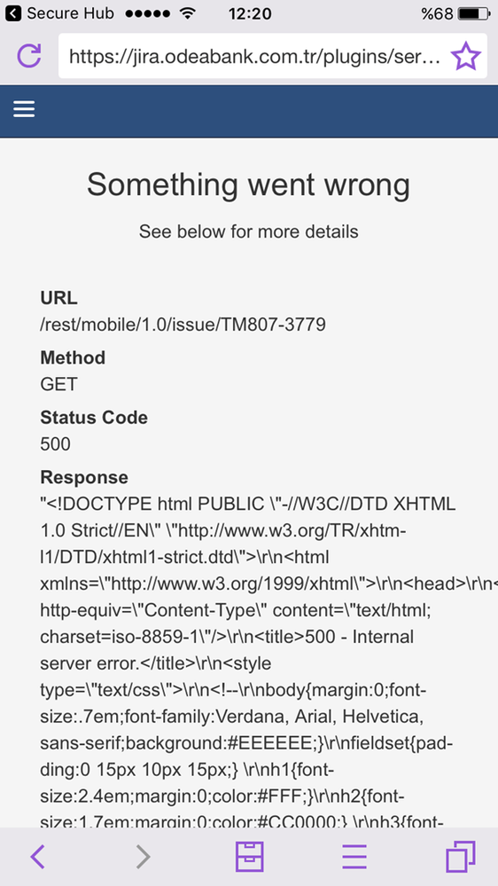

Jira runs behind IIS. Everything works fine while browsing from PC. But from mobile, the view issue page gets 500 error. No clue on what goes wrong.
The error can be reproduced by viewing the issue details page from chrome browser. After opening the developer tools and switching to mobile emulator you refresh the page and the error is there. Whatever device you choose the error is the same.
The error is related to mobile view. The desktop view is okey from mobile also.
