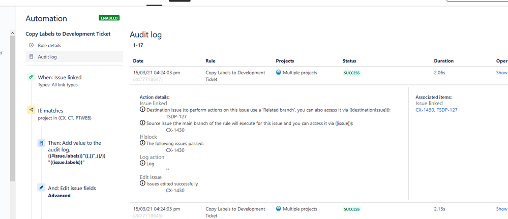

Hi @Ravi Sagar _Sparxsys_ Great video! How can I adapt this to copy labels from one issue to another when using the Issue Linked trigger?
Here's what I'm doing so far:
Any help would be greatly appreciated!
