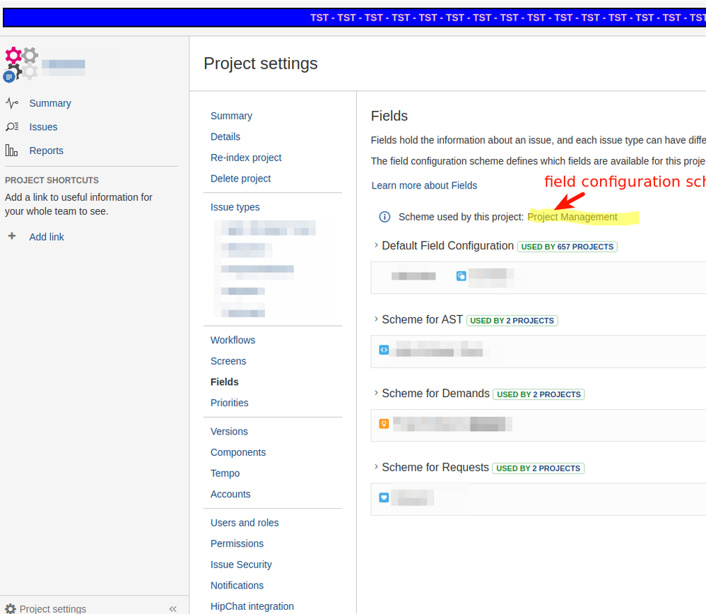

hi @Matt , yes, it makes sense. The problem is that schemes in Jira are quite often shared (as @Nic Brough -Adaptavist-  mentioned). Let me post some screenshots (it is on Jira 7.6.x, but the idea behind it is the same).
You have Project configuration (Project settings) and its field configuration says what field configuration scheme is used for the project. Each Field configuration scheme specifies what Field Configuration configures what issue type.
For example, in my case, Field configuration scheme is called Project Management and it specified three configuration for specific isue types (AST, Demands, Requests) and default field configuration for all the other issue types in the project (Default Field Configuration)

Ok, there's a "field configuration scheme" for the project which is what you see first when you click into field configurations from the project.
This should be a list of issue types (possibly only one - there's always a "default") mapped to different "field configuration"s.  You need to ensure you are using different field configurations for the two issue types.

@Matt if your configuration says that ONE field configuration is used by ALL or MULTIPLE issue types and it is not required, you need to make copy of the field configuration and adjust it. Then you need to adjust your FIeld Configuration Scheme so NEW field configuration is set for required issue type.

Ok, so you can use my screenshot. You can see there are multiple Field Configurations. These configurations are set for different issue types. As I wrote, if you have one Field Configuration assigned to every issuetype in your Field COnfiguraion Scheme, you need to make copy of the Field Configuration and adjust Field Configuration Scheme so required issuetype is assigned to NEW field configuration and all the other remains the same.
