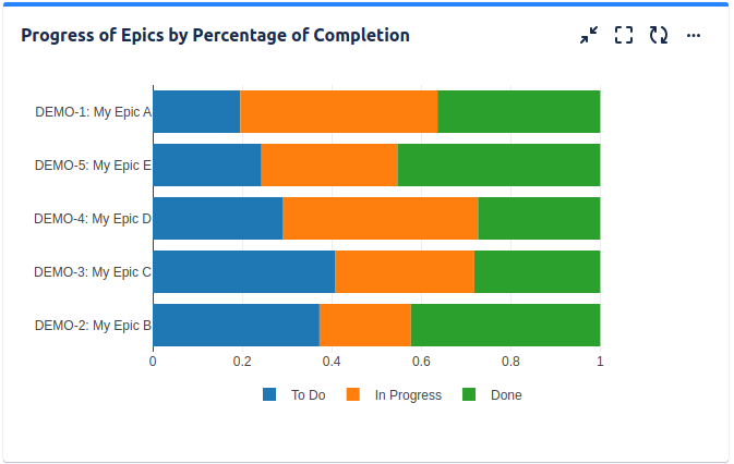

Progress Metrics: Measures task completion percentages
By using the Pivot Table & Pivot Chart gadget you can track the progress of the Themes, Initiatives, Epics and Stories based on their number of child items or sum of story points and display them as tables or charts.

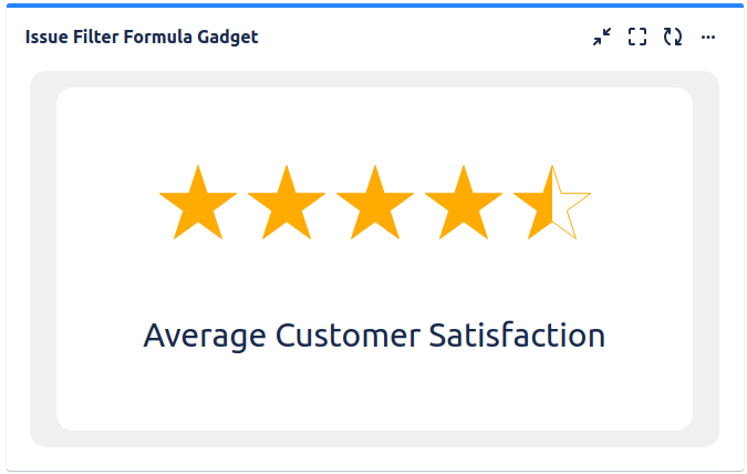

Stakeholder Satisfaction: Collects feedback to gauge satisfaction
By using the Issue Filter Formula gadget you can display average satisfaction score as a gauge chart or 5 star scale. See also https://community.atlassian.com/t5/App-Central-articles/How-to-measure-Customer-Satisfaction-in-Jira-and-Confluence-with/ba-p/2741012
