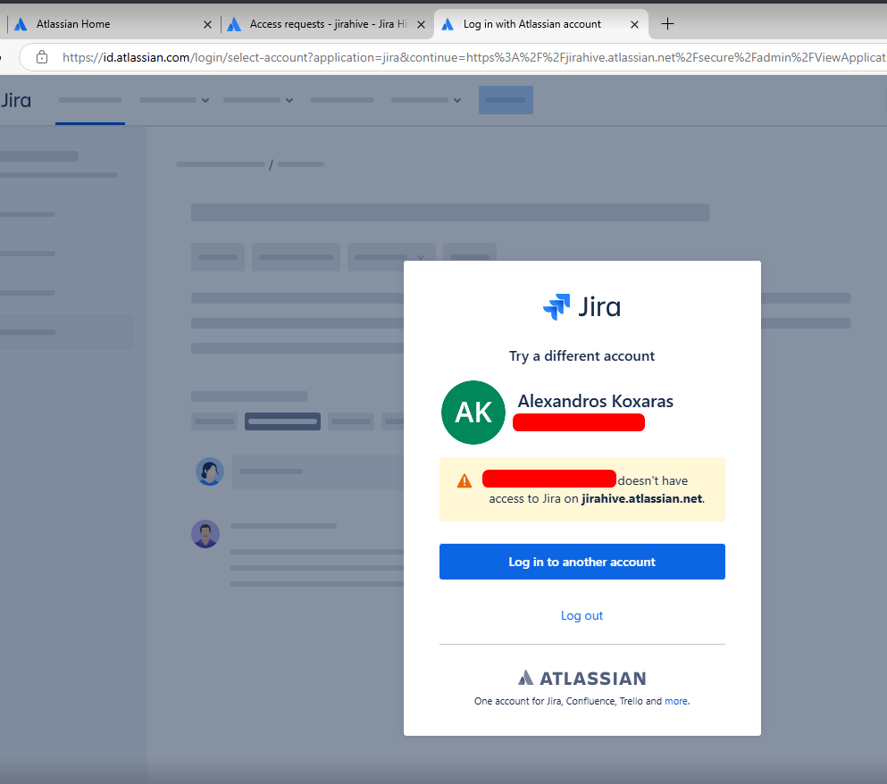

When I visit my custom login URL I get the following message:
Now, in a way I get it: The user doesn't have product access, so he shouldn't be allowed to login and view the projects etc. But I would expect to either login and navigate me directly to settings or to the main jira screen with view of the projects etc.

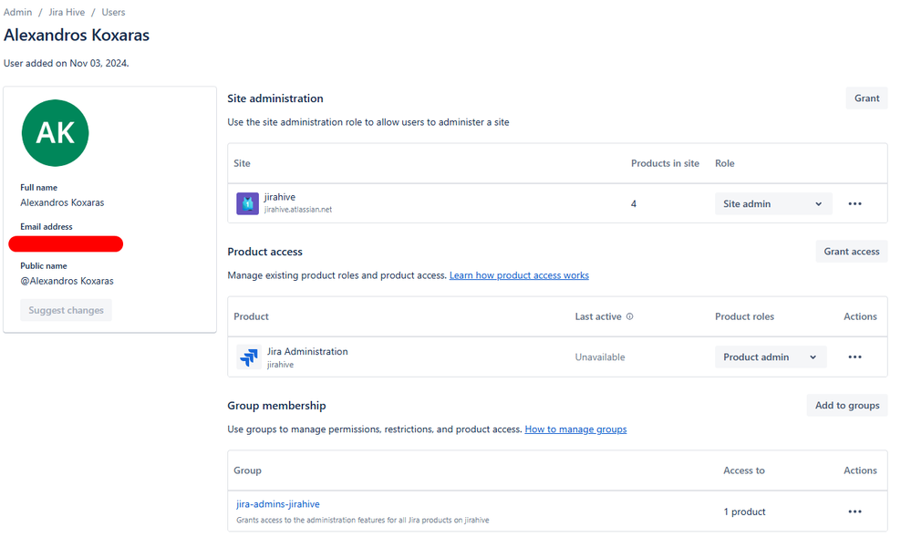

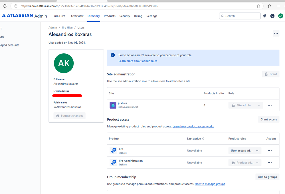

So my product admin user, which now has user access admin and is a site admin, is like that:

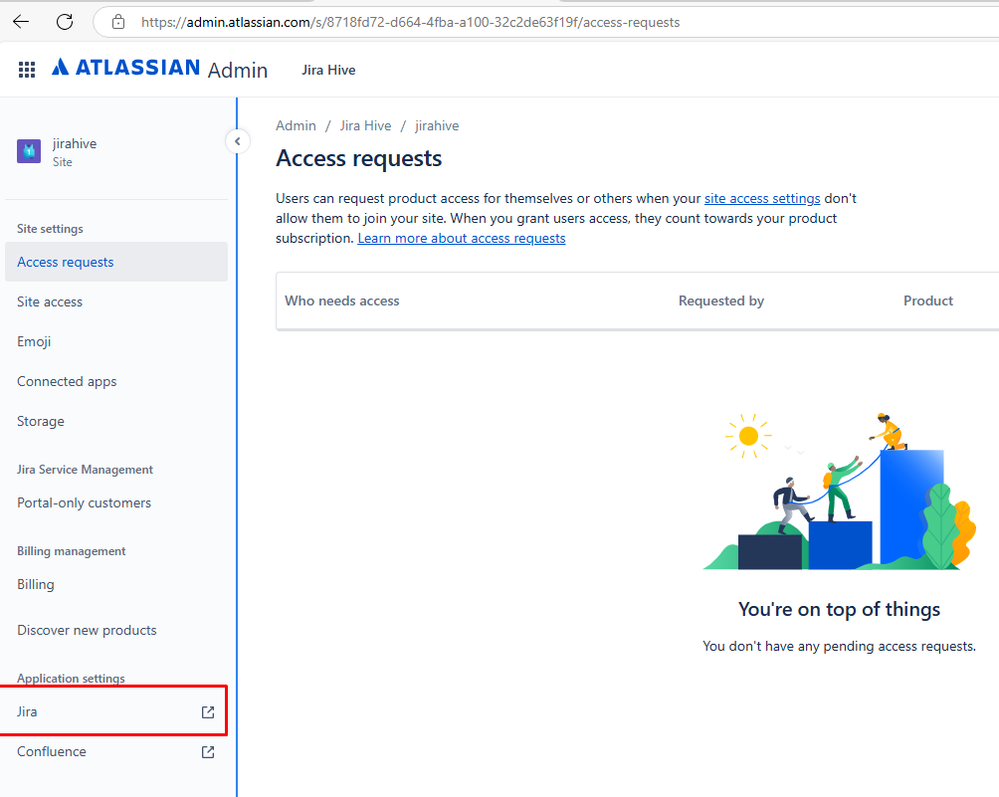

He is able to view the admin section via admin.atlassian.com and as a site admin he can navigate to the following screen, where he clicks to visit the jira instance:visit instance.png

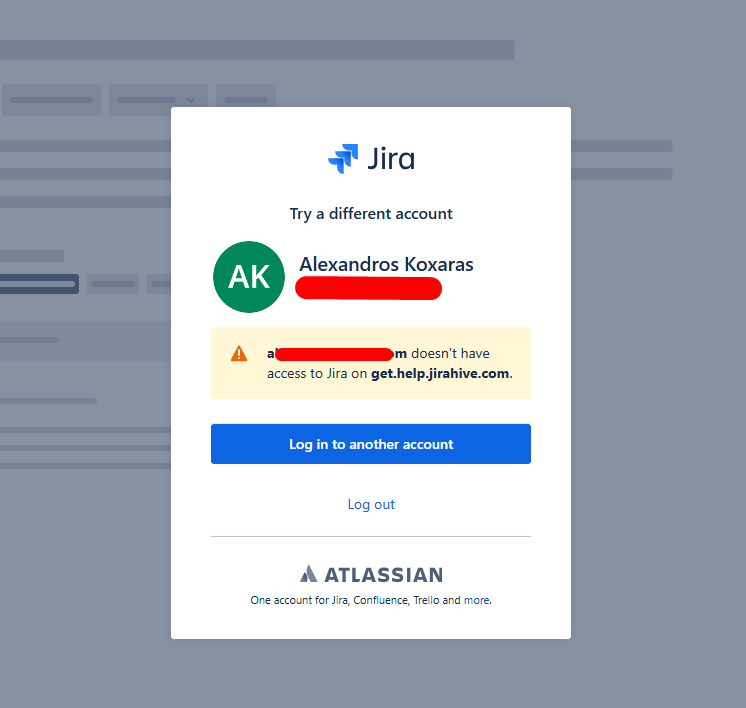

Now, I would expect that Jira will let him visit the instance, see only the project settings of the projects and actually do his jira admin magic. However, this is not the case and I'm presented again with the "you shall not pass" popup:

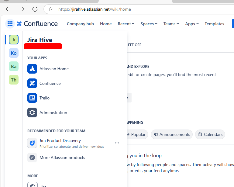

If you grant this user another product access, e.g. Confluence, he will be able to login to /wiki. From there, he can manually navigate to jira by using /jira, replacing the /wiki suffix.
Navigating on his switcher though, Jira is not visible as an option:

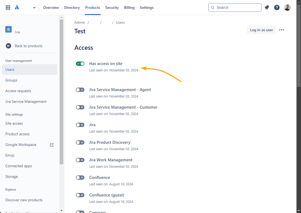

It seems that if you're on old user management experience you can grant user site permission - Has access on site, together with product administration permission (a.k.a., add that user to a jira-administrators group) and that would be enough. The user would be able to open <site-name>.atlassian.net/jira/ and work navigate to Jira administration from there.2024-11-03_19-21-40.png

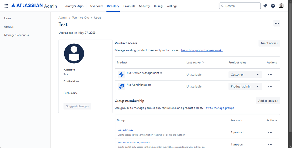

However, if you just grant the user a customer product role for JSM (which isn't a license), then it seems to work the same as in the scenario above; with the old user management experience.
