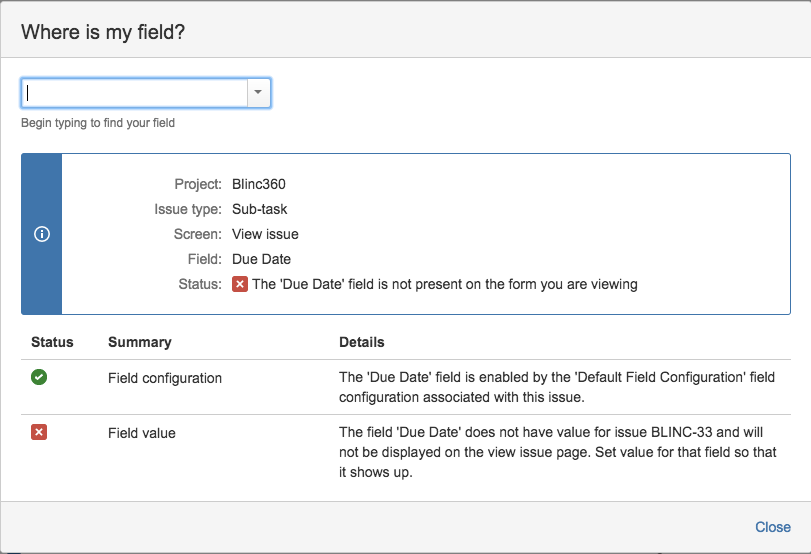

I have tried to add the due date by selecting a sub-tasks and then clicked on "where's my field" link.
When i select the due date column, ( refer to attached)
It gives me an error 'the Due Date field is not present on the form you are viewing'
Is there a value for due date in this issue? Fields are not visible, if they have no value.
Yes, it's not got a value, so it won't show on view.
As I said, you needed to go to the "edit" screen and use the "where's my field" from there if it's not on the screen for you to enter something for it.

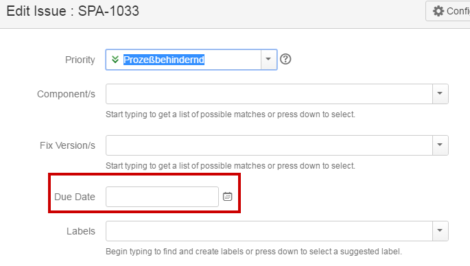

Klick on Edit:
Enter Due Date:

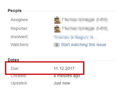

Then it should be visible in your issue view:
