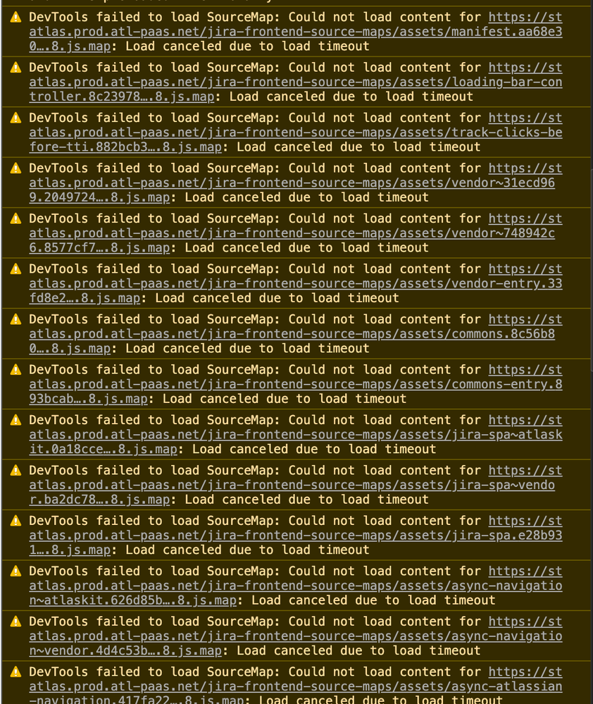

Can you please open the developer tools on your browser and check on the console tab if it shows any other error related to the gadget? If so, please, send us a screenshot (just make sure to hide private information).

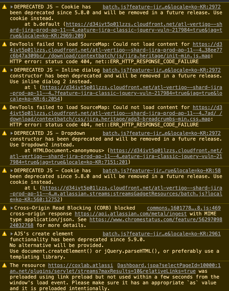

Below is the console log from chrome when I'm watching dashboard.
Thank you for the details, @SuminPark.
Those are the same warnings that show on my site, but the gadget loads normally.

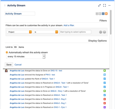

I recorded a gif showing how to filter by project:

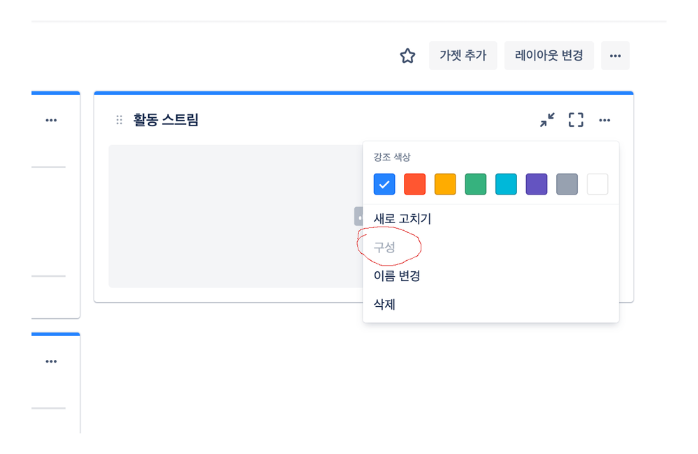

Can you share with us a screenshot of the issue?
I think if I create new dashbaord, It must show the setting panel firstly, but in my case, it doesn't show any setting panel, it goes loading state. and the configuration button is always disabled state. the red circle means configuration.
