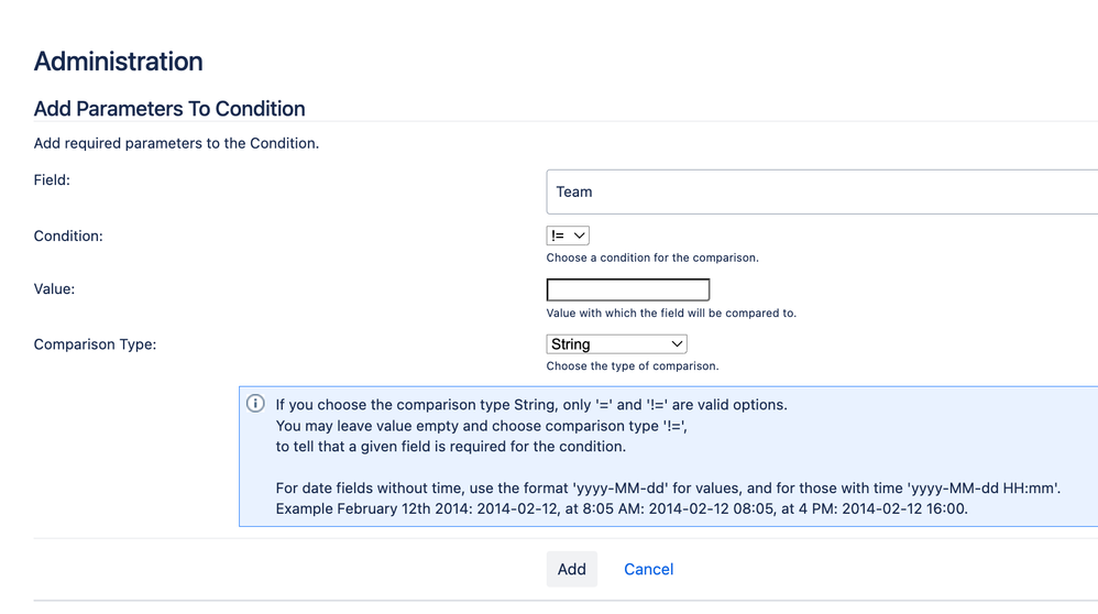

For the transition from In Dev to In Test In Dev you would want to add a Value Field Condition to hide the transition from the one Team. I have not experimented with this to see if you would need to enter the Team ID or the Team Name here. But this method would make the direct transition unavailable to the one team.
You can then add the additional status with a transition from In Dev to it, and a transition from it to In Test In Dev.
If you don't want other teams to use that new status and transition path, then you could put Value Field Conditions on each transition that the Team field must be set to the one Team. Then the transitions would be visible only to that one Team.
Thanks!! This worked, I used my team's GUID and only the one team can view it.
