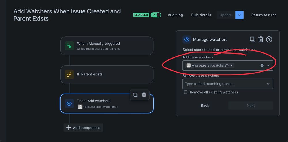

That is possible. I have created a rule like this:

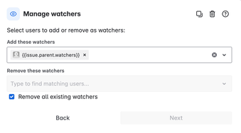

When an issue is created it checks whether it is a Task in this case and then removes the watchers that are already on the created Task + Adds the ones from the parent:
Using this Smartvalue:
{{issue.parent.watchers}}

Hi @Aravindh P , here's an example that you can use to create your rules. I think you will want two rules one triggered when issue is created and another if an issue is updated with a condition that the triggered issue has children.
Oh and on your second question, I am unsure. Just give it a try.
