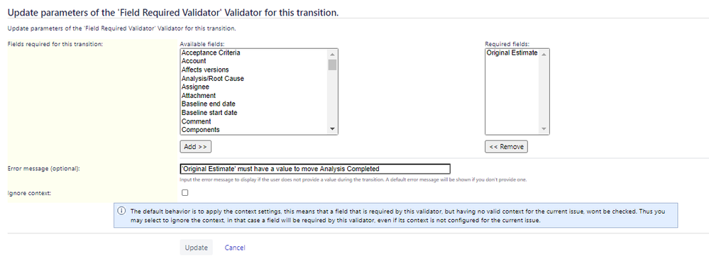

Recognising that this answer was written a while ago. It appears you now don't need to use Script Runner to perform this validation. You can add this validation directly in a Transition Validator. (Working Jira Cloud )
I saw issues that transitioned with 0m as estimation although we had this validator.
Any ideas why it's happening?
