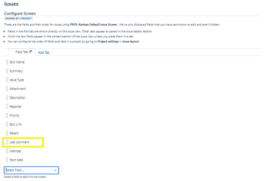

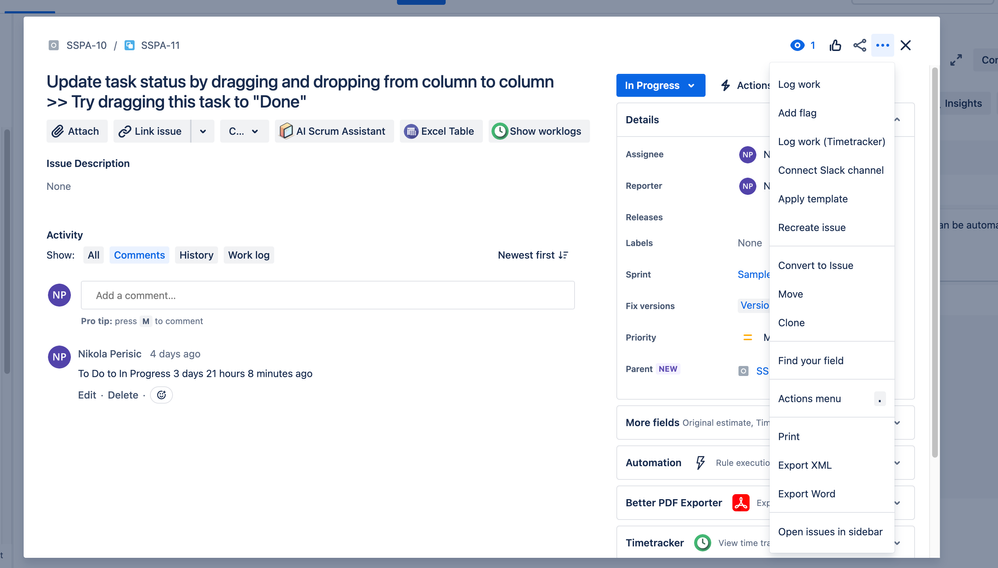

Hello @Sherry Nightingale
There are couple of things:
1.Make sure that this field is showing on the View screen of your project.
2.In order to find it, click on three dots on the view screen of the issue and click on "Find your field"

If it is on the view then i'm assuming I need to add it to the Edit screen?
Would this then make all previous Epics show this field as editable?
Sherry
Correct, you would need to add this to the edit screen as well. And yes, it should show this field as editable.
