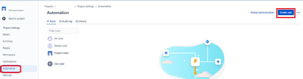

You can do this using Automation Rule. Below is the screenshot that you can follow to create the Automation Rule.
Go to Project Settings --> Automation
and follow the steps as per the below screenshot:
