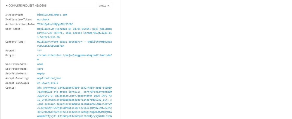

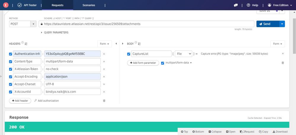

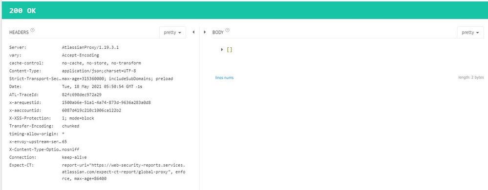

I am trying it on Talent APItester extension in chrome. Kindly find the attachment for more clear picture.
POST URL: https://tataunistore.atlassian.net/rest/api/3/issue/256509/attachments
Problem statement: Now I get 200 Response code but still attachment is not getting uploaded in respective issue. Please help.
Ah okay, so this APITester that you're using is a bit like Postman in that you don't write any code? In that case, I can't really help much because I know nothing about APITester or what's going on "under the hood".
